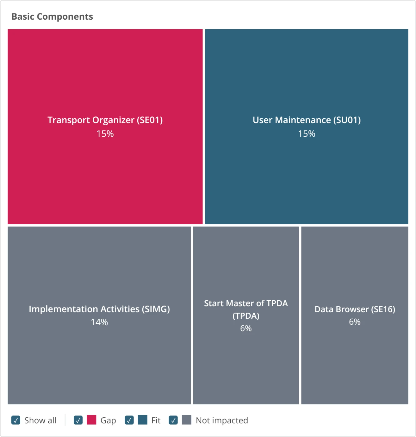

Review the two-level heatmap view generated by Change Impact Analysis to understand which application components and transactions are impacted by the selected transports, and whether each is a Fit or a Gap.
Change Impact Analysis, similar to the Heatmap offers a two-level view:
Application components—containers inside the heatmap that contain all the transactions used inside a specific application component.
Transactions—boxes inside the application containers that contain data about a certain transaction or program, such as: name, SAP code, and the percentage of test relevance in the heatmap. You can zoom in on a selected area of interest and focus only on a specific SAP component or module.
- Gap - The transactions impacted by the selected transports that are not covered by test cases.
- Fit - The transactions impacted by the selected transports that are covered by test cases.
- Not impacted - The transactions in the transport weren't impacted by the change.

- Under the heatmap, select Gap to see the transactions that are impacted and aren't assigned to test cases.
- Under the heatmap, select Fit to see the transactions that are impacted and are assigned to test cases.
- Under the heatmap, select Not impacted to see the transactions that aren't impacted by the changes.
- Select Show all (selected by default) to see all the above transactions.
