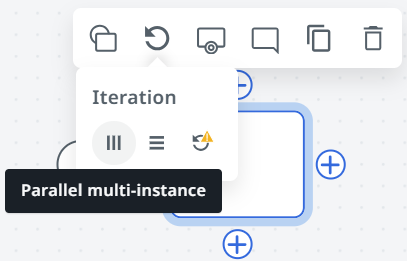

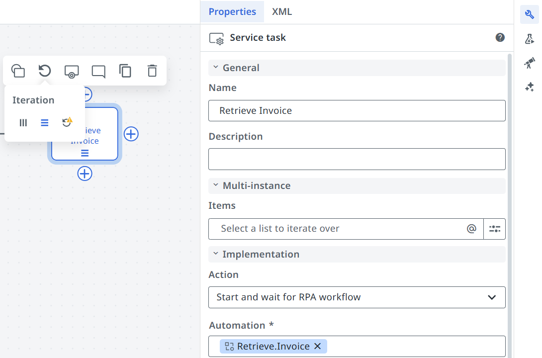

In the element toolbar above the task, select Iteration.
Choose Sequential multi-instance or Parallel multi-instance.
The marker appears at the bottom of the task shape.

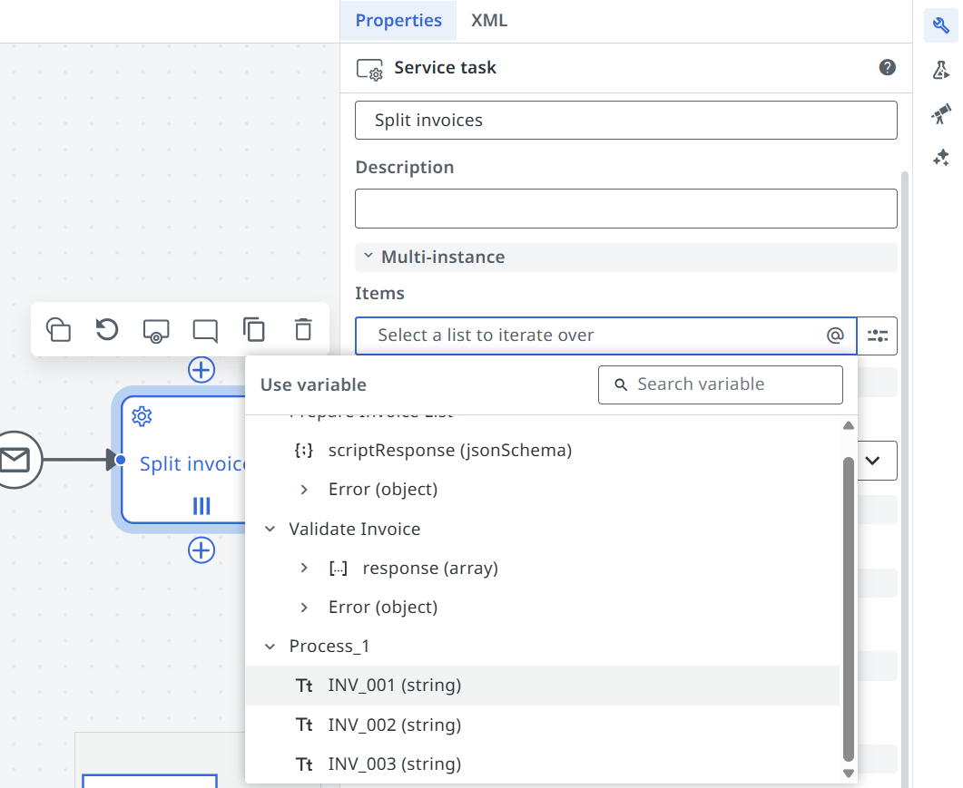

In the Properties panel, expand Multi-instance.
In Items, select the list variable you want to iterate over — for example,
vars.invoiceList.This tells Maestro which collection to process. Without an Items value, the task runs once as a normal task, not once per element. Maestro creates one execution per element in the list.
Optionally, expand Error handling and enable Retry on failure to retry individual item runs independently. For configuration options, see Element-level retries.

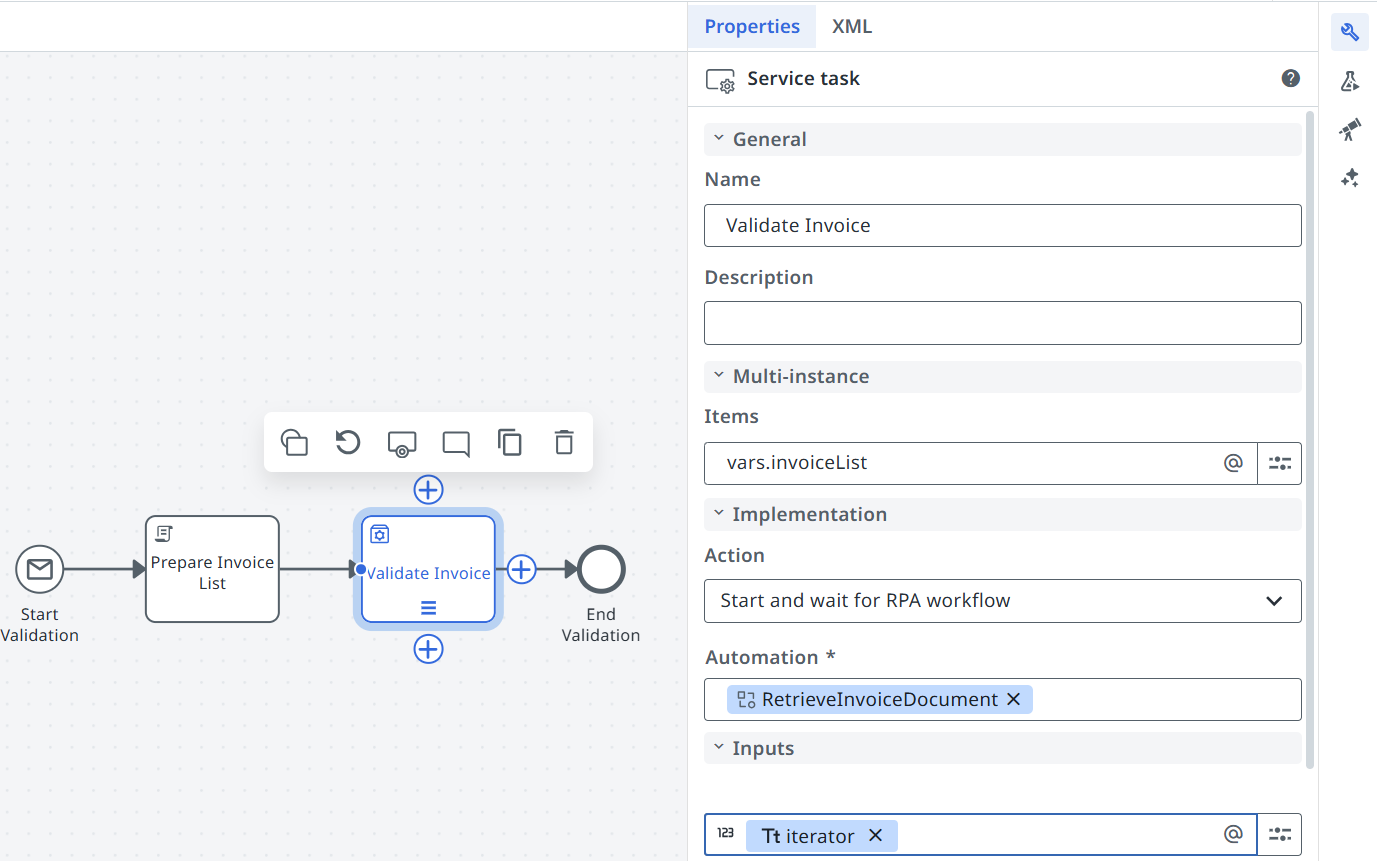

3. Convert the task to multi-instance
- With the task selected, open the element toolbar and select Select markers → Sequential multi-instance.
- In the Properties panel, expand Multi-instance and set Items to
vars.invoiceList.
4. Map the current item to an input
After selecting your action, the Inputs section shows the parameters defined by that action — for example, the input arguments of your RPA workflow or the parameters of your agent.
For each parameter you want to populate with the current list item, select its value field and enter iterator.item:
- Use
iterator.itemto pass the entire current element — for example, the string"INV-001"if your list contains strings. - Use
iterator.item.propertyNameto pass a specific property — for example,iterator.item.idif your list contains objects.
