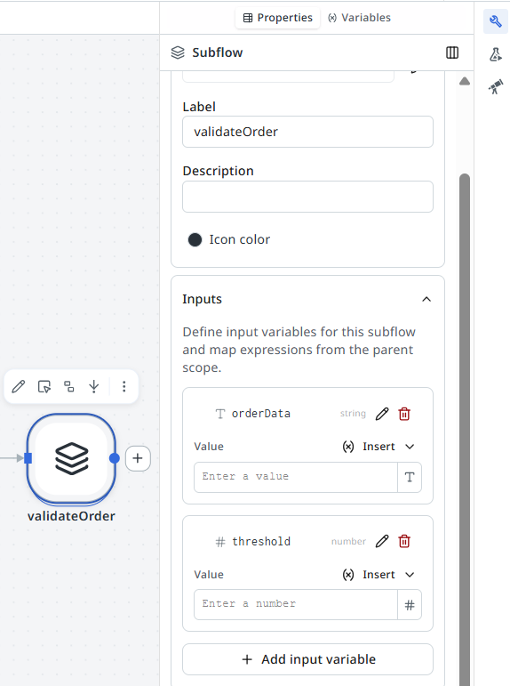

Passing data in and out
Inputs
You define subflow inputs in the properties panel. Each input accepts a value or expression from the parent process's scope.
To configure subflow inputs:
- Select the subflow node on the canvas.
- Open the Subflow Inputs section in the properties panel.
- For each input, enter a name and a value or expression.
Result: The inputs are configured and available inside the subflow body as $vars.<inputName>.

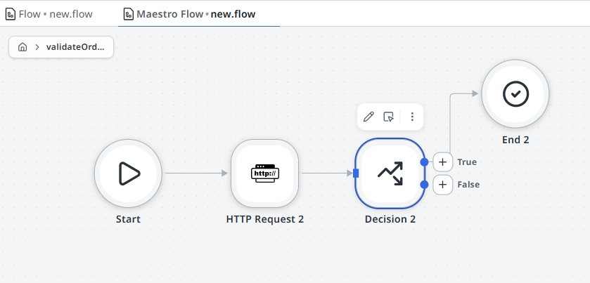

Practical example
A parent process that calls a subflow to validate order data before processing it.
Parent process:
- HTTP Request (
httpRequest1) — fetches order data from an external API. - Subflow (
validateOrder) — validates the order data and returns a result. - Decision (
decision1) — branches based on the validation result.

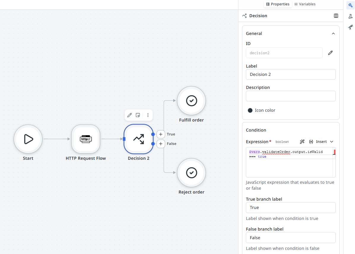

Back in the parent process:
The Decision node evaluates $vars.validateOrder.output.isValid === true and routes to either a fulfillment path or an error-handling path.
