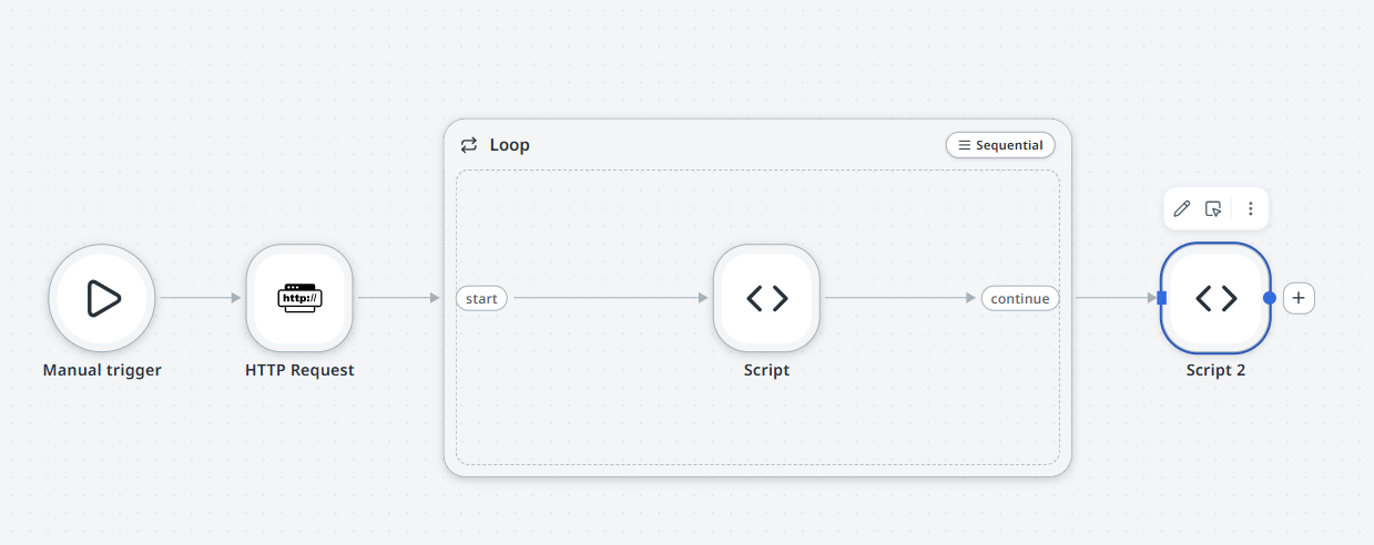

Loops repeat a sequence of nodes multiple times. Flow offers two loop nodes for different situations.
Loop (For Each)
The Loop node iterates over a collection (an array) and executes its body once per item. It exposes three variables inside the loop body:
  • currentItem — the item for the current iteration
  • currentIndex — a zero-based index tracking which iteration is running
  • collection — the full array being iterated
After all iterations complete, the Loop produces an output array that aggregates the results from every iteration. Execution continues from the success handle.
A Loop node's Collection expression points to the array it iterates over, such as $vars.script1.output. The Parallel option runs all iterations at the same time instead of sequentially. Nodes connected to the loop output handle form the loop body, and the node connected to the success handle runs after all iterations complete.

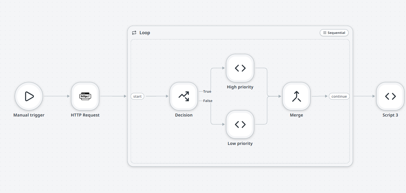

Merging branches
After a Decision or Switch splits your process, use a Merge node when downstream nodes must run regardless of which branch was taken.
The Merge node accepts multiple incoming edges on its single input handle and produces one output. The last node of each branch connects to the Merge, and the process continues from the Merge output handle.
Note:
Merge waits for the branch that actually executed — it doesn't wait for all incoming edges. Only the branch that received data during the current run passes through.
Practical example
Consider a process that fetches a list of support tickets, loops over each one, and routes high-priority tickets differently from the rest.
The process wires together five nodes:
  1. An HTTP Request node calls a ticket API and returns an array of ticket objects.
  2. A Loop node iterates over $vars.httpRequest1.output.body.tickets.
  3. Inside the loop body, a Decision node evaluates $vars.loop1.currentItem.priority === "high". The true branch connects to a Send Email node that alerts the on-call team; the false branch connects to a Script node that logs the ticket for later review.
  4. A Merge node connects both branches so the iteration completes cleanly regardless of which path ran.
  5. The Merge connects back to the Loop's loopBack input, and the Loop's success handle continues to the rest of the process.
This pattern — fetch, loop, branch, merge — covers a large portion of real-world automation scenarios.
