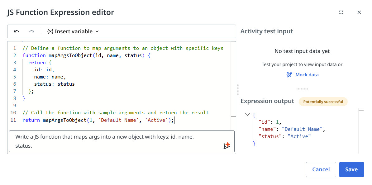

You can test expressions inline by selecting the fx icon to open the JS Function Expression editor The editor includes:
- A test input panel where you can paste sample inputs.
- A real-time Expression output panel to preview what your return object will look like.
Runtime errors (e.g., JSON.parse failures) will be shown to help you debug.

The JS Function Expression editor includes Autopilot for Maestro assistance that helps you write and refine JavaScript expressions directly in Script tasks. You can describe the logic you need in plain language, and Autopilot generates a function that you can review, edit, and test in place. The editor shows a live preview of the expression output and lets you insert variables from your workflow, so you can build and validate custom logic without leaving the canvas.
