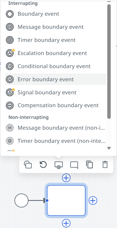

Resolve discrepancies error boundary event
If the agent cannot resolve the discrepancy, it will return a business error, routing the task back to a human for further input. Model this by adding an Error boundary event to the task.
Select the Resolve discrepancies task and choose Add boundary event from the element toolbar.
From the boundary event picker, select Error boundary event.
Select the Error boundary event, choose Add: Task from the toolbox, and Enter Resolve discrepancies for the task name. Add Action Center Action app as an annotation to indicate we want this to be a human-in-the-loop task.
Select the new Resolve discrepancies task. Use the Connect tool again to draw a line from the this new task to the agent gateway.
