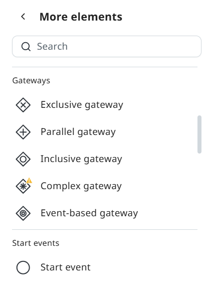

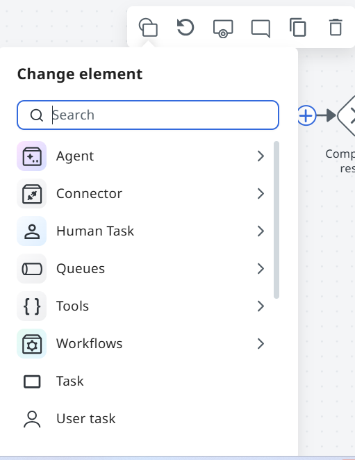

Using the element toolbar
When you select a BPMN node, a floating element toolbar appears, letting you quickly extend the process with context-aware components.
To use the toolbar:
- Select an element to reveal the toolbar.
- Select the Change element icon to open the Change element panel.
- Choose an element from the list, or select More elements to browse the full set of supported BPMN elements grouped by category.
- Select the desired element to replace or extend the current node.
Result: The element is updated and ready to configure in the Properties panel.
Result
The new element is inserted, auto-connected to the selected node, and ready to configure.
This speeds up process design—especially helpful for building multi-step flows or branching logic.
