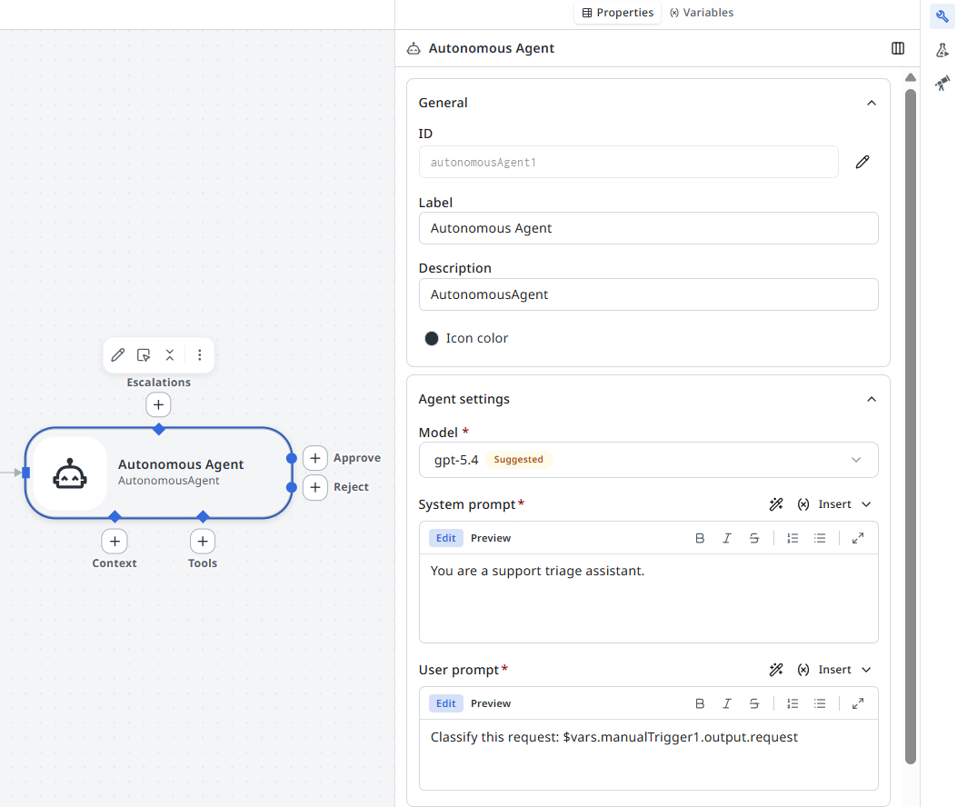

Add the node, then configure it in the properties panel.
  1. Select the + button on an output handle, or open the node palette from the bottom toolbar.
  2. Select the Agent category, then Autonomous Agent. Flow adds the node and opens its properties panel.
  3. Configure the model and prompts as described below.

FieldRequiredDefaultDescription
ModelNoOrganization default agent modelThe large language model (LLM) the agent uses. Select a model from the picker, which lists the models available to your organization.
System promptYesNoneThe agent's role and standing instructions: who it is and how it should behave. Write durable guidance that applies to every invocation, such as the agent's persona, constraints, and output expectations.
User promptYesNoneThe task for this invocation. Reference workflow data with expressions, for example $vars.start.output.request.

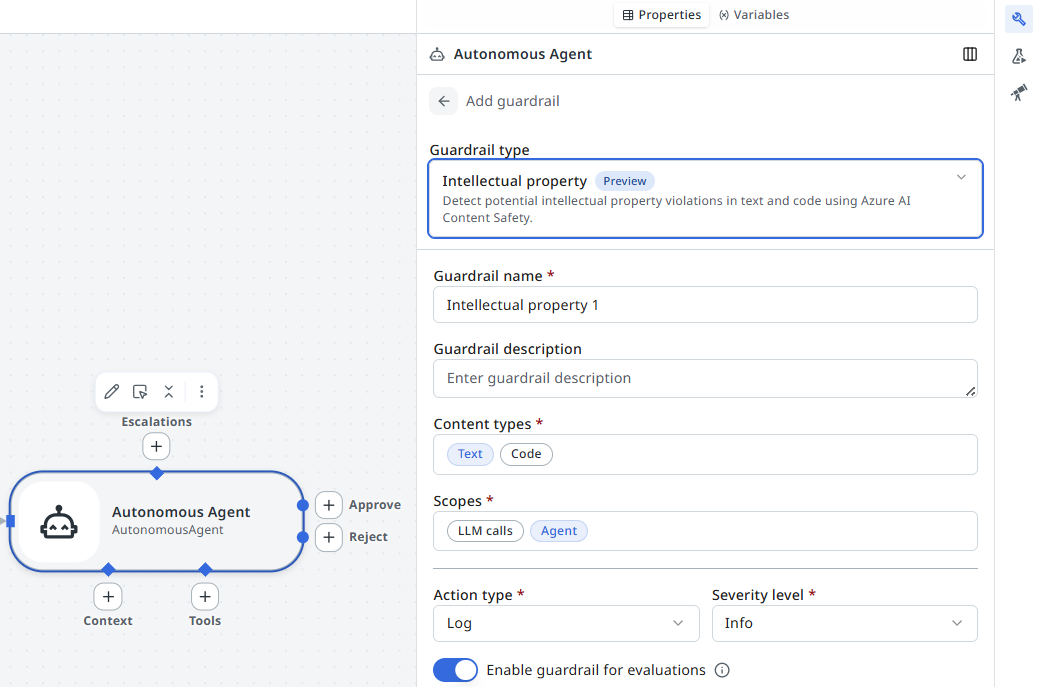

GuardrailsNoNoneRules that constrain the agent's behavior and outputs, such as blocking disallowed content or keeping the agent within a defined scope. Guardrails apply to the agent as a whole.

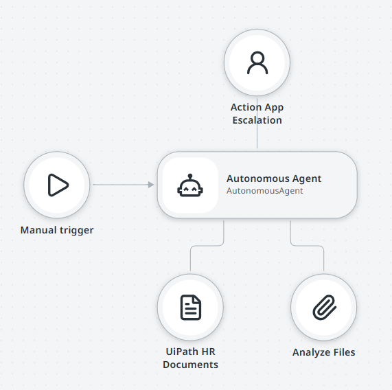

Resources​
An Autonomous Agent composes with resource nodes you connect to its handles. The node has three resource handles, each with its own label in the canvas: Tools, Context, and Escalations. Connect a resource to a handle, then configure that resource in its own properties panel. The resources travel with the flow.
Each handle accepts only its matching resource type. The canvas blocks connections that don't fit, so you can't, for example, wire a tool to the context handle.
Tools​
Connect tools to the Tools handle to give the agent capabilities it can call while reasoning. The agent decides during its loop whether and when to call each connected tool. Each tool carries a description that tells the agent what the tool is for, so write clear descriptions when a tool exposes one.

Context​
Connect a context resource to the Context handle to ground the agent in your data. The agent draws on this grounding data while reasoning instead of relying on the model alone. A context resource points at a context index in your organization.
Configure how the agent retrieves from the index, including the retrieval mode (semantic, structured, DeepRAG, or batch transform), the query, the number of results to return, a relevance threshold, and whether to include citations. To create a new context index, use the Create new Context action on the handle's add panel, which opens index creation in a new tab.
Escalation​
Connect the Escalations handle to route to a person when the agent reaches a case it shouldn't decide alone. The agent pauses, a human acts on the escalation, and the agent resumes with the outcome. You can attach either of two escalation resources:
  • Escalation: routes to an action app task. Configure the action app, recipients, notifications, the inputs passed to the app, and how the app's outcome maps back to the agent.
  • Action App Escalation: routes to a coded action app, with the same recipients, notification, input, and outcome-mapping configuration.
Both escalation resources are configured the same way. Choose Action App Escalation when your escalation target is a coded action app rather than a standard action app. Attaching either resource requires version 1.2 or later of the Autonomous Agent node.
Escalation nodes now support the same Form schema view already available on Human Quick Approval nodes, showing an inline preview of the schema as you build it. Previously, escalation nodes only offered the JSON view.

Example 2: Resolve an invoice query end to end​
What it does: answers a customer's invoice question by reading the invoice, grounding the answer in policy, calling a workflow when it needs to act, and escalating when the amount exceeds a threshold.
Wire the agent's handles:
  • Context: a context index holding your billing policy, so the agent grounds its answer in approved guidance.
  • Tools: an Analyze Files built-in tool to read the attached invoice, and an RPA Workflow tool that issues a refund in the billing system.
  • Escalations: an Escalation resource that routes high-value cases to a reviewer in an action app.
