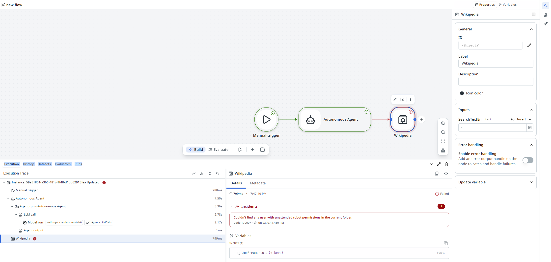

Debugging in Flow happens on the same canvas where you build. There's no separate debug view — you run your process, inspect results in the execution panel, and make changes when you spot an issue.
Starting a debug session
The Debug button in the toolbar runs the process. The execution panel appears at the bottom of the screen and spans populate in real time as each node executes.
The Stop button ends the session explicitly. Any change to the process also exits the debug session automatically.
Refer to The Canvas for a full overview of debug controls and the execution panel layout.

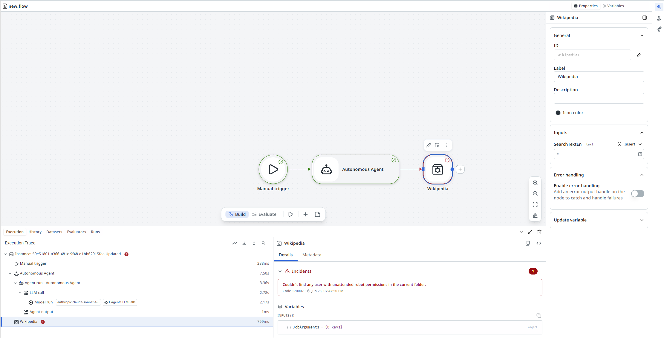

Reading the execution panel
The execution panel has three tabs. Each one answers a different question.
Spans
The Spans tab shows the execution trace — every node that ran, in order, with timing and a success or failure indicator. Selecting a span highlights the corresponding node on the canvas, making it easy to see exactly where execution reached.
Incidents
The Incidents tab collects errors that occurred during the run. Each incident names the node that failed and includes the error message. If your process stopped unexpectedly, check here first.
Variables
The Variables tab shows runtime variable values. Select a span in the Spans tab and the Variables tab updates to show the state at that point in execution. Use this to verify that upstream nodes produced the data you expected.
Identifying failures
After a debug run, each node on the canvas shows a success or failure indicator. The failed node's span in the Spans tab highlights it on the canvas. The Incidents tab shows the error message. The failed node's properties panel shows the full error object in the output section.
The error object includes a message field (human-readable description) and a detail field (technical cause). Start with message because it contains the user-facing failure summary.
