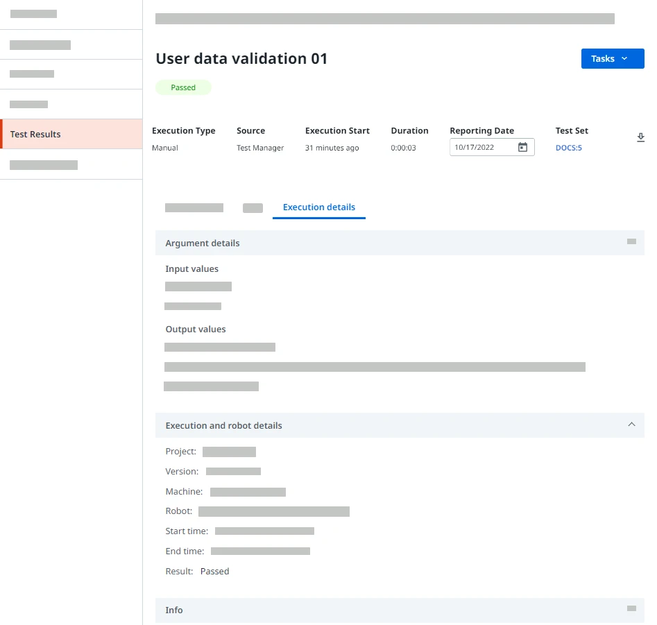

Execution log
As part of test reporting, execution logs hold information such as execution details (e.g., data variation and screenshots), failed and passed assertions, and a detailed log of execution events.
To open a test case log, go to Test Results, open a test execution and then click a test case Key.
In the following table, you can view the type of information that is collected during test case execution.
Test execution reporting Description
Assertions
View failed or passed assertions (e.g.,Verify expression activity), and associated screenshots if any were taken during test case execution.
To make sure that Orchestrator takes screenshots during executions, visit the following resources:
  • Default roles in Orchestrator - to check if the default roles have the Test Case Execution Artifacts permission assigned. In case the default roles don't have this permission, then you can create a custom role with this permission.
  • Managing roles in Orchestrator - to learn how to create, edit, or import a role in Orchestrator.
Logs
View INFO level logs as part of the RobotLogs, with information about processes, execution robot, and event logs.
Execution details
View argument details such as input and output values, as well as execution and robot details (e.g., project, machine, robot).
Affected requirements
View the requirements that are assigned to the test case that has been executed. You can use this tab to go directly to the affected requirement.
