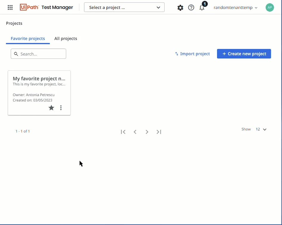

To export an existing project in Test Manager:
  1. Sign in to Test Manager. Choose the project you want to export, and select More Optionsdocs image . The Export Project panel opens.
    Warning:
    Test Results aren't included in the export file.
  2. Select the test objects that you want to include in the export file, and then select Export.
  3. Wait for the export process to finish and open the Project Export Completed notification that you receive via email.
  4. Select Download. You are redirected to the Test Manager instance from where you exported, and the export TMH file downloads automatically. In case the download doesn't start automatically, select Download.
