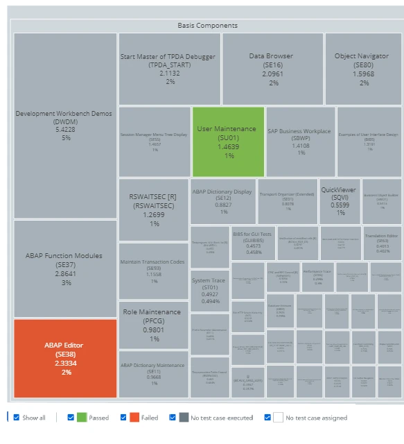

You work with a two-level heatmap view:
  • Application components: Visual containers that group related SAP transactions under a specific component or module.
  • Transactions: Boxes inside components representing individual SAP transactions or programs. Eachbox displays transaction data, such as:
    • Transaction name
    • SAP code
    • Testing status and coverage
Viewing test coverage for transactions
To see which transactions have automated tests, and the results:
  1. Under the heatmap, select Passed to see the transactions that passed their test results.
  2. Under the heatmap, select Failed to see the transactions that failed their test results.
  3. Under the heatmap, select No test case executed to see the transactions for which no test case was executed.
  4. Under heatmap, select No test case assigned to see the transactions that don't have any test cases assigned to them.
  5. Under heatmap, select Show all (selected by default) to see all the above transactions.

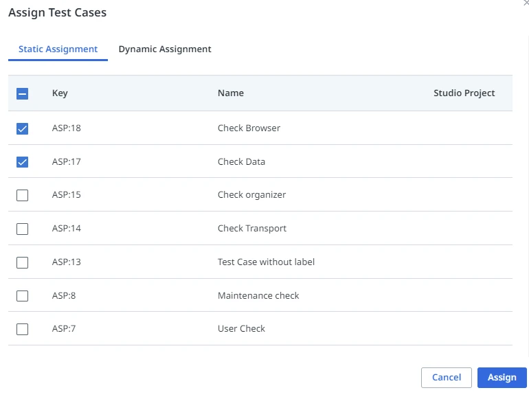

  3. After you create the test set, navigate to Test Sets in Test Manager.
  4. Search for the test set you created and open it.
    You can search for the test set using the label that you added at Step 3.
  5. Select Tasks > Assign Test Cases > Static Assignment.
  6. Search for the test cases that you created at Step 1 and assign them to this test set.
  7. Navigate back to the Heatmap page, select the transaction, and check out the test set assigned to it.
