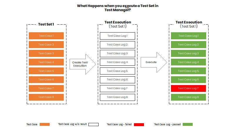

When you start executing a test set, Test Manager goes through the following process:
  1. A Test Execution is created in the Test Results section of Test Manager. This serves as the container for the test results.
  2. For every test case within the executed test set, an empty Test Case Log is generated. This log is attached to the Test Execution and will hold its associated test results.
  3. As the execution continues, the Test Manager fills each Test Case Log with results and related log information.
Note:
Every time a test execution is created, Test Case Logs for all associated test cases from the original test set are added. This means existing Test Executions remain consistent, regardless of updates or deletions made to the original test set.
The chart below illustrates the process of executing a test set in Test Manager.
As a consequence, after a test set has been executed, any changes to the test set or its associated test cases do not affect the results from previous executions. Even when a test set is deleted, all the test executions remain unchanged.

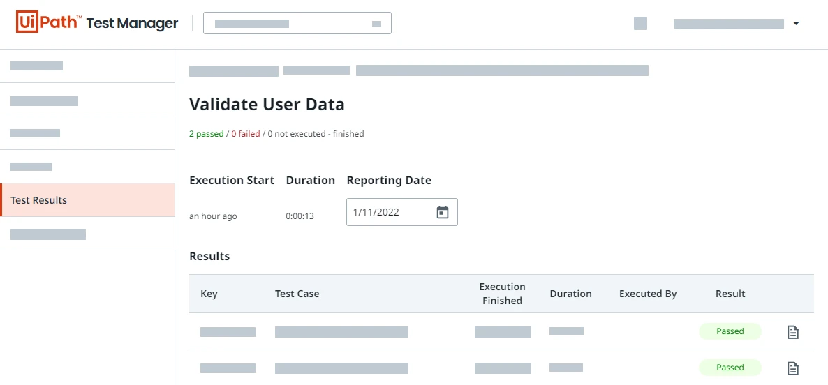

To get detailed results from a test execution, go to Test Results and click an entry to open the detailed view. A typical test execution detailed view shows information on when the executions started, duration, and execution logs.
You can use the Reporting Date filter to set a single date for all the results from the test execution. This is useful when you run tests overnight, where some test cases are executed before and after midnight. Otherwise, the results are going to be split between different dates in the reports.
In the Results section you can examine all the test cases that were executed within the test set. You can take actions for each test case. For more info, see Execution log

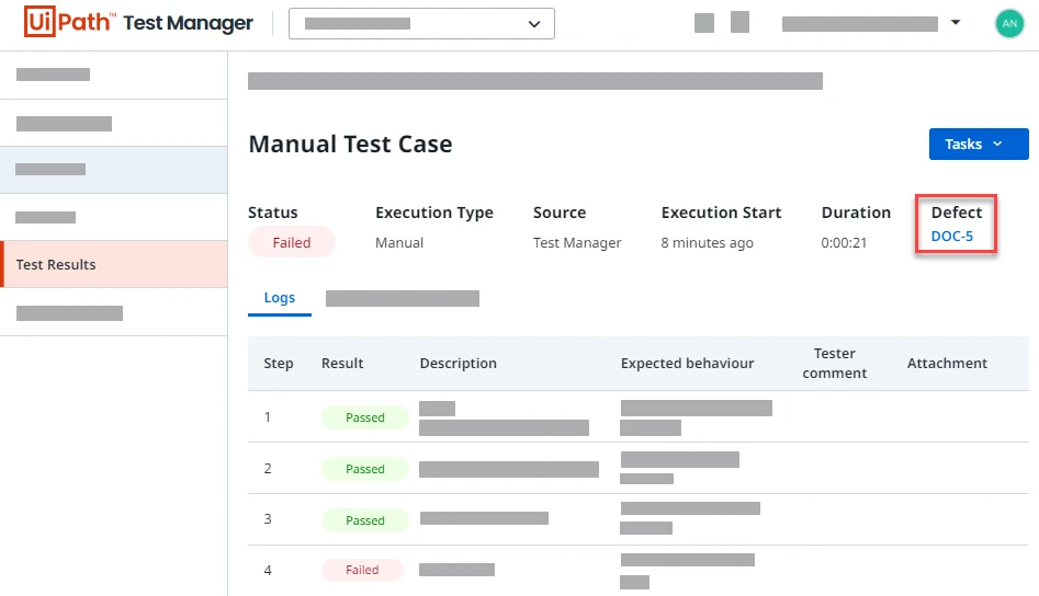

Create defect
You can create defects when you access test case logs in the Test Results page.
  1. Navigate to Test Results
  2. Open a test result and the click the test case key to open the logs.
  3. Click Tasks and select Create Defect.
The defect is created and synchronized with your external tool. You can open the defect directly in the tool (e.g., Atlassian Jira) by navigating to the test execution result that has a synchronized defect.
