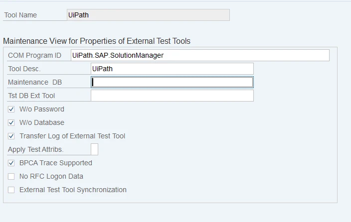

Register Studio
  1. Open SAP Logon and go to the transaction SE16.
  2. Enter ECCUST_ET in the Table Name field.
  3. Click Create New Entries.
  4. Configure the entry details. Ensure you enter the exact COM Program ID: UiPath.SAP.SolutionManager.
  5. Save your data and exit the transaction SE16.
