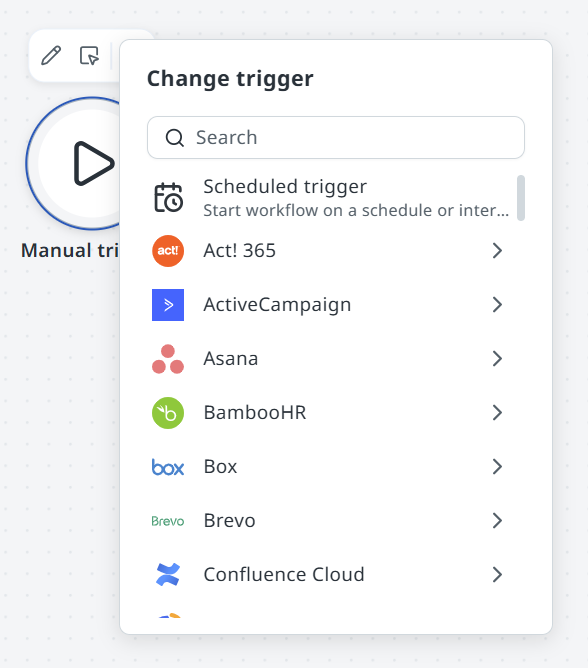

A new workflow starts with a Manual trigger, which starts a run on demand, for example to test the workflow. To start it another way, replace the Manual trigger from the Change trigger list:
- Form trigger (Preview): starts the workflow when a human submits a form.
- Scheduled trigger: starts the workflow on a schedule.
- Connector trigger: starts the workflow when an event happens in a connected app.
- HTTP Webhook: starts the workflow when a call arrives at a web address.
- Incoming call (Preview): starts the workflow when a phone call arrives.
- Conversation trigger (Preview): starts the workflow when a user begins a chat.
- Queue trigger: starts the workflow when a work item is added to a queue.
