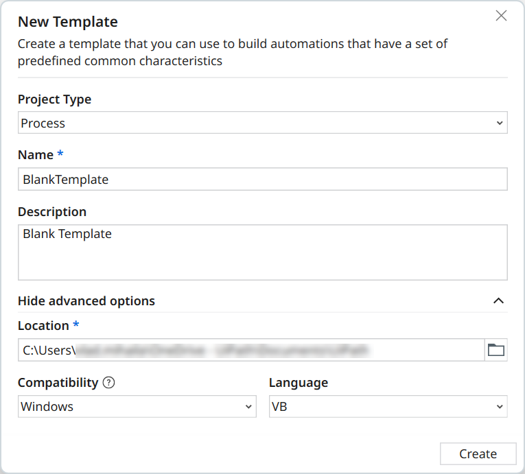

Creating a Template
  1. In the Studio Backstage view, under New Project, click Template.
  2. In the new template window, configure the following:
    • Choose between a Process and a Test Automation type of template.
    • Enter a name for the new project (up to 128 characters) and a description that summaries what you are aiming to do with this automation project (up to 500 characters).
    • Select the location where to create the project. The default location where projects are created is %USERPROFILE%\Documents\UiPath.
    • Select the compatibility and language.
  3. Click Create and your template opens in Studio.

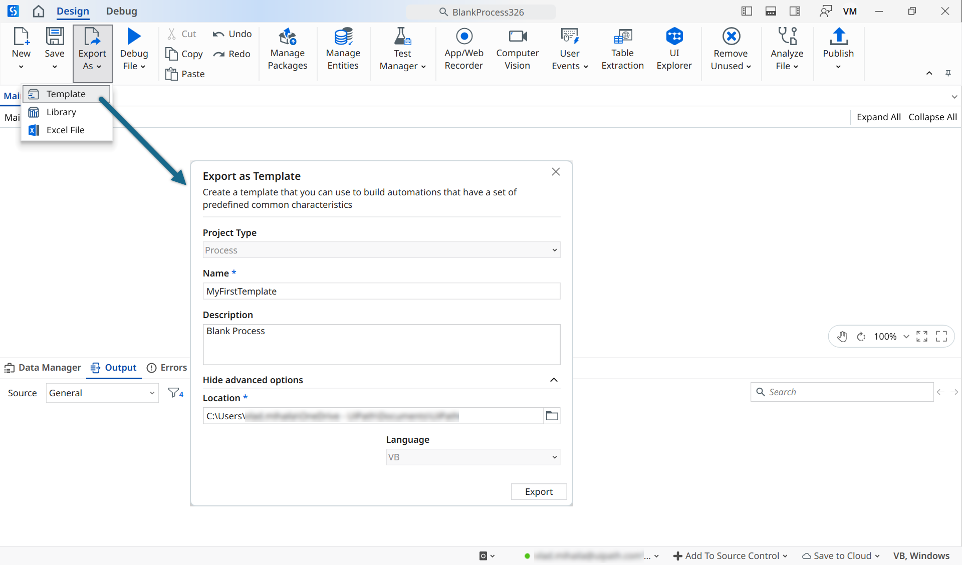

Exporting a Project as a Template
Processes and test automation projects can be exported as templates, published to a certain location, and then made available in the Templates tab in Studio's Backstage view.
A process, test automation, or modified built-in template opened in Studio can be exported using the Export As > Templates ribbon button.
docs image
When exported, the template is saved under the path in the Location field.

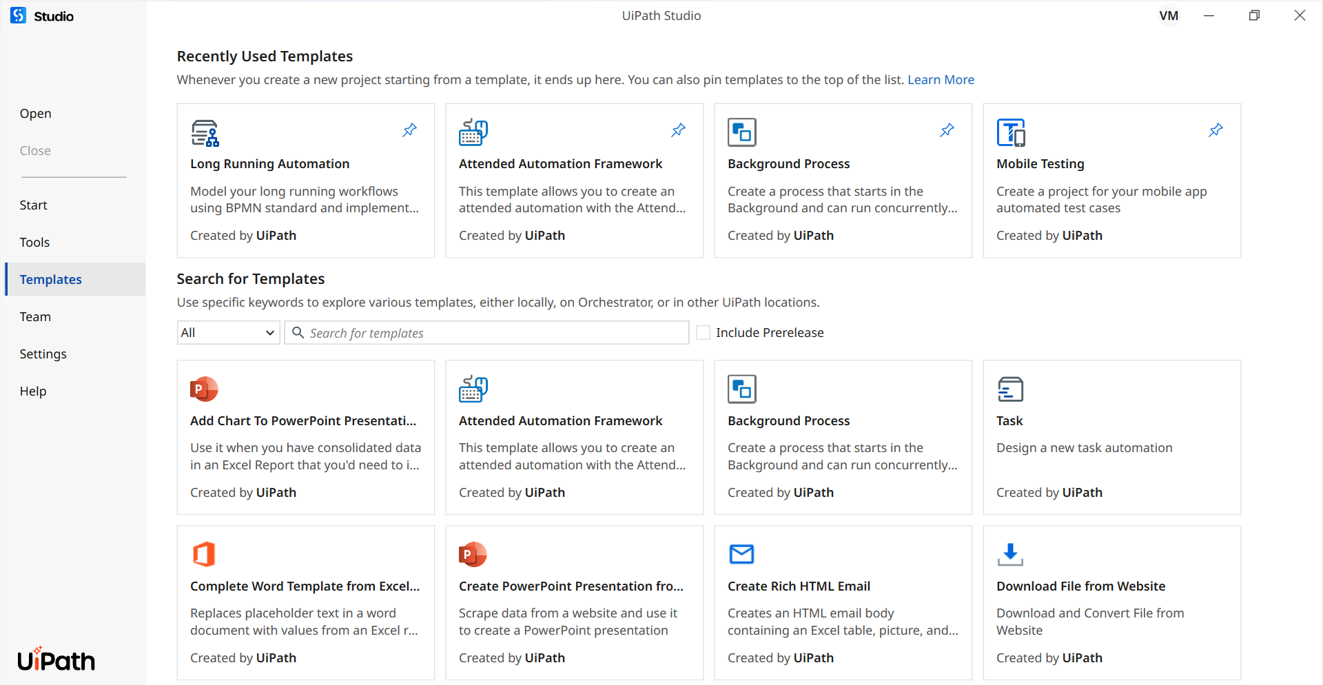

Browsing and Using Templates
You can view all available project templates in the Templates tab in Studio Backstage View.
Recently used templates are listed at the top. You can search for templates by name and description, select whether to include prerelease versions, or filter templates by location.
The following template locations are available:
  • All - All locations.
  • Built-in - Templates that come installed with Studio.
  • Official - Templates from the official UiPath feed.
  • Orchestrator - Organization-wide templates feed, available when connected to Orchestrator.
  • Local - The local user feed, by default: C:\Users\User\Documents\UiPath\.templates. The location can be defined by selecting Settings > Locations in Studio Backstage view.
  • Marketplace - Templates published to the UiPath Marketplace.
