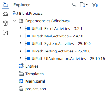

By default, the project folder includes the following files and subfolders:
  • Files
    • Main.xaml - Created by default to hold your main workflow. In addition, all the other automation XAML files you add to the project are stored in the project folder. Optionally, you can set a different file as main. All the files must be linked through the Invoke Workflow File activity to the file set as main or to a file marked as an entry point to the project. For test automation projects, a TestCase.xaml file is created by default instead of Main.xaml.
      Note:
      • You cannot run Windows projects that contain a XAML file named Init.xaml.
      • A XAML file placed in the root folder of a project cannot have the same name as a subfolder which contains other XAML files.
    • project.json - Contains information about your automation project.
    • AGENTS.md - Describes the project to AI coding agents, including its layout and the uip rpa commands that validate, build, run, and publish it. When you create a project inside a solution, a single shared file is placed in the solution root folder instead. Studio never overwrites an existing file with this name. Creating this file can be turned off through governance.
    • CLAUDE.md - Imports AGENTS.md for Claude Code. Created together with AGENTS.md.
  • Subfolders
    • .entities - Contains data about entities imported from the Data Service, if any are used in the project.
    • .local - Contains data cached locally for the project. When an activity package used by the project ships documentation, Studio copies it to .local/docs/packages/<PackageId>/ after each package restore, so coding agents have context about the packages the project depends on. A .local/docs/manifest.json file records the package versions that were copied.
      Note:
      • The .local folder is hidden. You can enable viewing hidden items from the Windows File Explorer settings.
      • The .local folder should not be shared across projects.
    • .objects - Contains data related to items added to the Object Repository, if any are used in the project.
    • .project - Contains tags added to the project.
    • .screenshots - Contains informative screenshots generated in UI automation activities, if any are used in the project.
    • .settings - Contains activity project settings used at runtime.
    • .templates - Contains file templates added to the project.
    • .tmh - Contains data related to test cases, if any are used in the project.

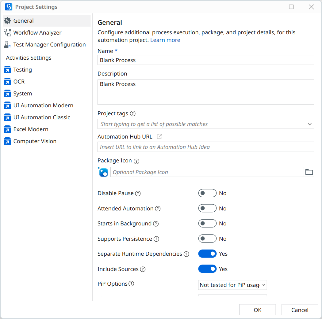

Setting the Minimum Robot Version​
The Minimum Robot version of a Windows or Cross-platform project is the oldest Robot version that can run the project. Each option corresponds to the .NET version the project is built for:
Minimum Robot version.NET version
22.4.NET 6
24.10.NET 8
26.10.NET 10. This is the default for new projects.
Robots older than the selected version cannot run the published package. Newer Robots can always run it.
You can set the minimum Robot version in two places:
  • In the new project window, select Show advanced options, and then select a version from the Minimum Robot version drop-down menu. For the built-in templates, the new project window preselects the version you chose last. Projects created from a user-defined template, or extracted as a library from another project, keep the version of that template or project.
  • In the General tab of the Project Settings window of an existing project, select a version from the Minimum Robot version drop-down menu. Changing the value reloads the project to apply the new version.
Projects keep their current version until you change it. The setting is not available for Windows - Legacy projects, which use .NET Framework 4.6.1, or in the StudioX profile.

Explorer panel controls​
ControlDescription
Search docs imageSearches inside the project.
Create new project file Create new project file iconAdds new files and folders to your project.
Filter by file type docs imageFilters the files of the current project by type: Workflows, Test Cases, Forms, Code, Text, Objects (disabled by default), Show hidden folders (disabled by default). To view all files, select Other (disabled by default).
Select the More actions docs image button to access additional options:
OptionDescription
Expand AllExpands all nodes in the automation project.
Collapse AllCollapses all nodes in the automation project.
RefreshRefreshes the project.
Sync with Active DocumentFocuses on a project element that's active in the Designer panel.
Open in File ExplorerOpens the project's location on the machine.
Project SettingsOpens the Project Settings window for processes or libraries.
Export AsExports the project as template, library, or an Excel file.
Manage EntitiesOpens the Manage Entities window.
File and Workflow Icons​

Adjusting Project Settings​
A set of individual settings can be established for each automation project that you’re working on. Such settings are available in the Project Settings window, which can be opened by clicking the docs image in the Project panel.
Field Description for the Settings Window​
The following table describes the project settings for process, test automation, and template projects. For information about the settings available for libraries, see About Libraries.
Field
Description
Name
Change the name of the project. Such names may contain whitespace characters. When naming projects, keep in mind that whitespace characters are removed at publish time. This field accepts up to 128 characters.
Description
Change the project description. This field accepts up to 500 characters.
Project tags
You can add one or more tags to the project, either by creating new ones or by reusing tags already defined in Orchestrator. There are two types of tags: labels and properties (key-value pairs). Tags are included in the published package and they help describe and categorize projects. For example, they can refer to the automated application (an Excel label) or the department (a department:accounting key-value property).
When you start typing, possible matches are suggested from already defined tags, and you can reuse one by selecting it from the list of matches. For a property match, the key followed by the : (colon) character is displayed first, and the associated values are displayed after you select the key.
To add a new tag, after you enter the name, click the entry with the plus sign next to the name. Separating strings with the : (colon) character enables you to add properties, while entries that don't contain a : add labels.
Labels and key-value properties are limited to 256 characters. Tag names can't contain these characters: <, >, %, &, \, ?, /,:.
Project tags can be automatically applied to processes in Orchestrator. For more information about using tags, see Organizing resources with tags in the Orchestrator guide.
Automation Hub URL
URL of an Automation Hub idea linked to the project. For more information, see Linking a Project to an Idea in Automation Hub .
Package Icon
Optionally, define a custom icon for the project. You can browse to and select a file, or enter a path or public URL to a jpeg , jpg , or png file up to 1MB in size.
After the project is published, the icon is displayed as follows:
  • For processes, in the Assistant next to the process name, making it easier to identify it in the list of processes.
  • For templates, next to the template in Home (Studio Backstage View) > Templates .
  • For libraries, next to the package in the Manage Packages window in Studio.
The icon is not visible in Manage Packages if a local file is used for a library published to Orchestrator or a feed that does not support embedded icons, In this case, specify the icon using a URL.
The oldest Robot version that can run the project, which also sets the .NET version the project is built for. Changing the value reloads the project. Available for Windows and Cross-platform projects.
Disable Pause
Enable or prevent users from pausing execution from the UiPath Assistant. Set to Yes if pausing the process during execution would result in crashing it. For example, if an activity in your workflow uses the Timeout property, pausing the execution might cause the timeout to expire, thus breaking the execution.
Attended Automation
Set to Yes to indicate that the project should only be executed in an attended context. Use this setting for projects that include UI Automation activities or other activities that require user interaction.
Starts in Background
Set to Yes to turn the project into a Background Process and allow it to run in the background concurrently with other processes, as long as it does not use UI interaction.
Supports Persistence
Set to Yes to mark that the process supports persistence.
Separate Runtime Dependencies To increase Robot performance and reduce the size of published packages, libraries are separated into design and runtime packages. The design package is used by Studio and the slimmer execution package is used by the Robot.
Include Sources Set to Yes to package all .xaml sources within the published package, including workflows that were previously made private. For Windows - Legacy libraries, the files are saved in the generated assembly file and in the lib\net45 folder in the .nupkg file. For Windows and cross-platform libraries and processes, the files are saved in the content folder in the .nupkg file.
PiP Options
Indicate whether the project was tested using Picture in Picture (PiP) and whether it should start in PiP by default.
  • Tested for PiP usage; Starting in PiP - The automation has been approved to run in PiP mode. When run, it starts in PiP by default.
  • Tested for PiP usage; Not starting in PiP by default - The automation has been approved to run in PiP mode. When run, it starts in the main session or desktop by default.
  • Not tested for PiP usage - The automation has not been approved to run in PiP mode. When run, it starts in the main session or desktop by default. If run in PiP, a dialog informs the user it was not tested using this feature and prompts for confirmation before proceeding.
PiP Type
Select how to isolate the automation from the user session when running the project in PiP: New Session (child session on the machine) or New Desktop (virtual desktop in the user session).
Click OK and the changes are made visible in the Project panel and project.json file.
