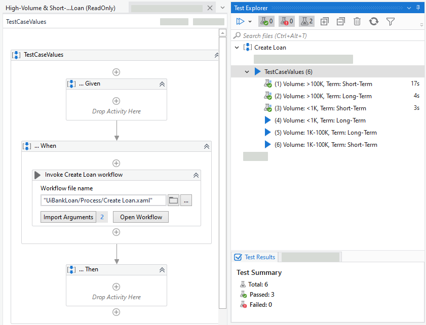

Test Explorer is a panel that shows information relevant to test automation. You can use Test Explorer and its sub-panels to group tests together, perform debugging, or analyze activity coverage.
Within a Process project, both test cases and workflows are shown by default, whereas within a Test Automation project, the Test Explorer panel shows, by default, only test cases . For example, if you have a data-driven test case, it shows up collapsed by default, with the number of variations placed under parentheses (e.g., TestCaseValues (6)).

According to the image above, from left to right, you can take the following actions from the Test Explorer header:
  1. Run All test cases in View.
  2. Run or Debug test cases.
  3. Filter the panel based on passed test cases.
  4. Filter the panel based on failed test cases.
  5. Filter the panel based on not executed test cases.
  6. Filter the panel based on manual test cases.
