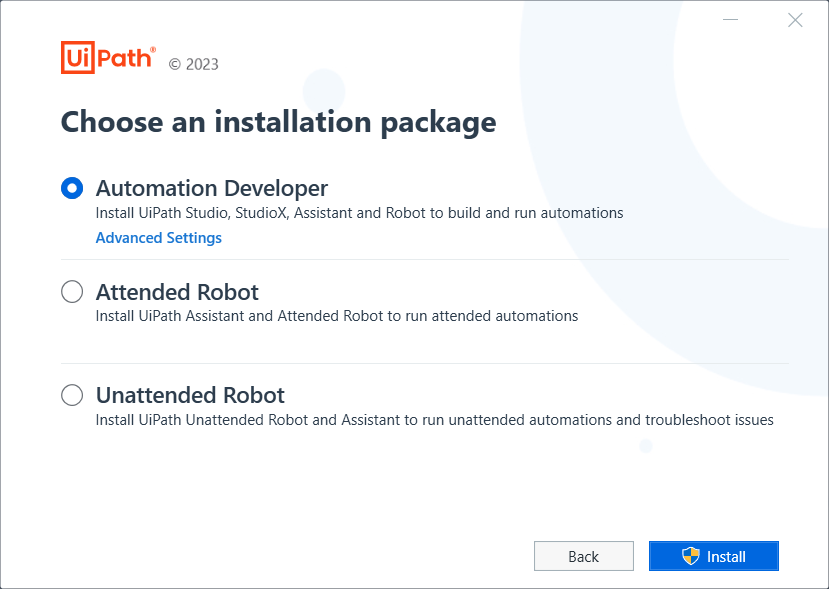

  4. If you opted for a custom installation, select the install mode, and then select Choose Packages to continue.
    • Install for me only - Install in the user profile folder, no administrator privileges required.
    • Install for all users on this computer - Install for all users, get access to more integrations and unattended automation, requires administrator privileges.
    docs image
  5. Select an installation package:
    • Automation Developer - Installs UiPath Studio, Assistant, and Robot for creating and running automations. The following components and options are selected by default:
      • Studio, StudioX and Assistant
      • User-mode Robot
      • StudioX Excel Add-in (if Microsoft Excel is installed on your machine)
      • Chrome extension (if Google Chrome is installed on your machine)
      • Edge Chromium extension (if Microsoft Edge Chromium is installed on your machine)
      • JavaScript Robot Add-on
    • Attended Robot
      • Installs UiPath Assistant and Robot for running attended automations. The following components and options are selected by default:
      • Assistant
      • User-mode Robot
      • Automatically Start Assistant with Windows
    • Unattended Robot - Installs UiPath Robot for running unattended automations (via Orchestrator) and UiPath Assistant for troubleshooting. This option is available only if you selected to install for all the users on the machine. The following components and options are selected by default:
      • Assistant
      • Service-mode Robot
    docs image

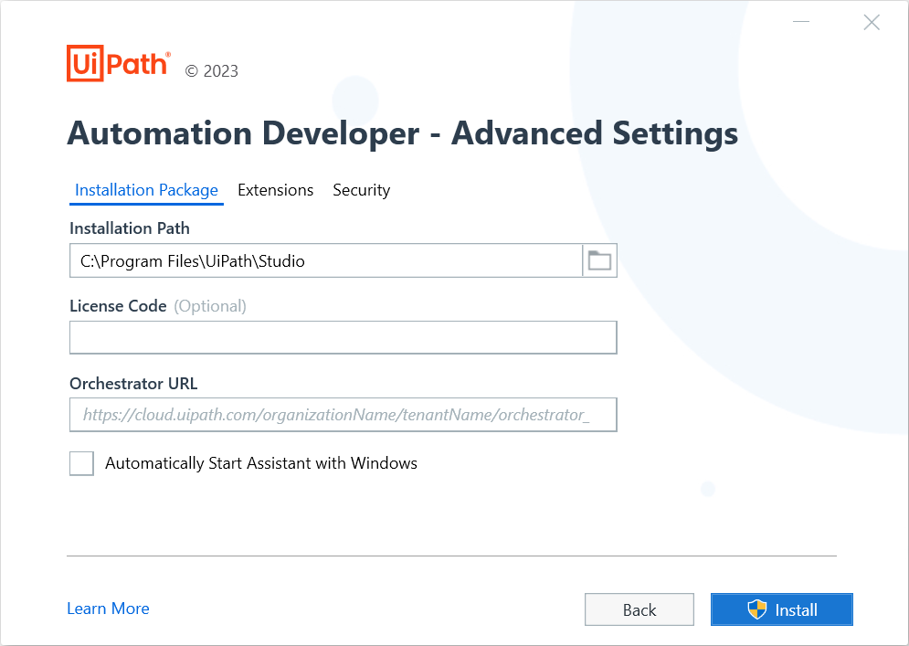

  7. If you opted to customize the installation, configure the following advanced settings, and then click Install:
    • Installation Package tab:
      • Installation Path - Select the folder where to install UiPath. The default location is %LocalAppData%\Programs when installing for the current user and %ProgramFiles% when installing for all users on the machine.
        Note:
        For information about security considerations when selecting a custom installation path, see Deployment guidelines.
      • License Code - Optionally, enter your stand-alone trial or enterprise license key, if available. If you are installing as part of a trial of the on-premises UiPath Platform and do not enter a license code, you are prompted to provide it when you launch Studio for the first time. This option is available only when installing for all users on the machine.
      • Orchestrator Service URL - Allows you to define the URL of the Orchestrator instance to connect to using Interactive Sign-In. The provided URL is saved in the uipath.config file.
      • Client ID and Client Secret - This option is only available when installing the robot as service mode. It allows you to connect the robot to Orchestrator using Client Id and Client Secret at install time.
      • Automatically Start Assistant with Windows - Launch the Assistant at Windows startup. This option is available for the Automation Developer and Attended Robot packages when installing for all users on the machine.
      • Automatically Sign In - If you install the attended robot in user mode and your environment is configured to use SSO with Azure Active Directory, you can enable automatically signing in to Orchestrator.
