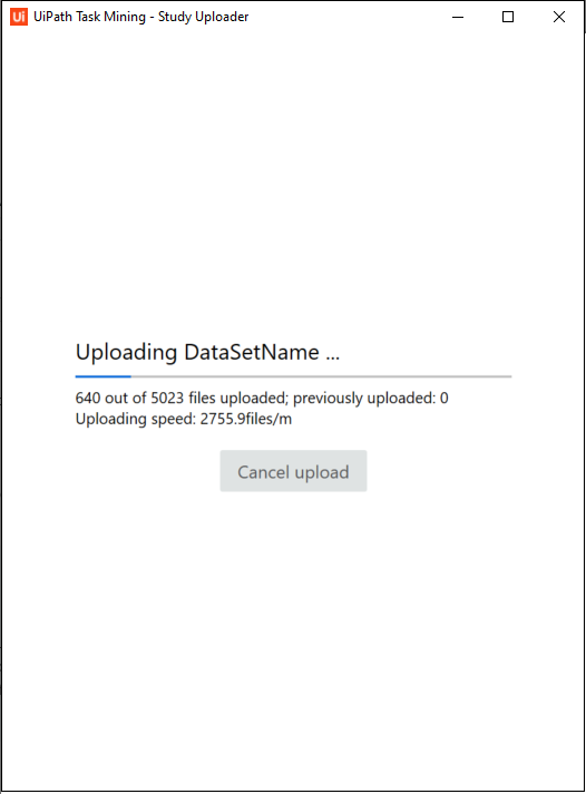

- The default number of files that can be simultaneously uploaded is set up to 5 in order to enhance the flow's performance. Furthermore, a speed metric is displayed on the Upload page to provide information about the uploaded files/minute.

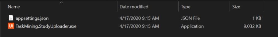

Access the PC location where the StudyUploader.exe is saved. Run it. Refer to Setting up the Uploader for details.

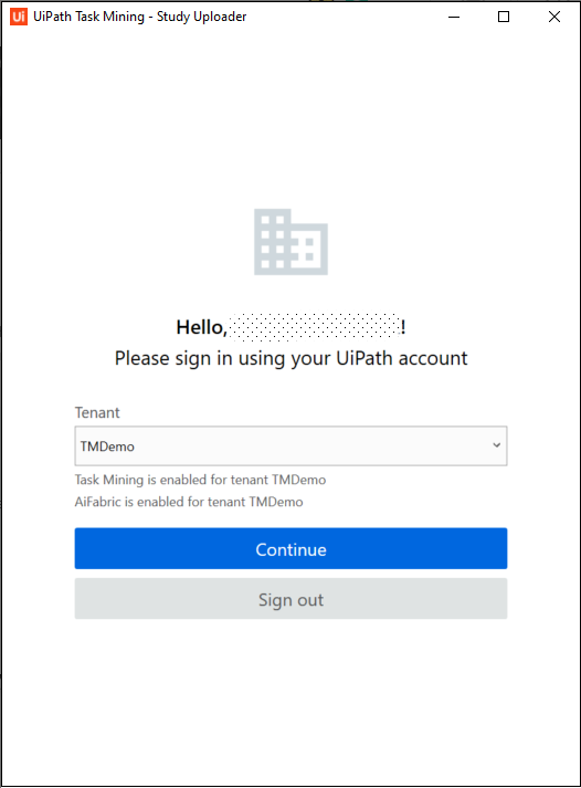

The authentication pop up is displayed. Click the Sign In button to proceed.

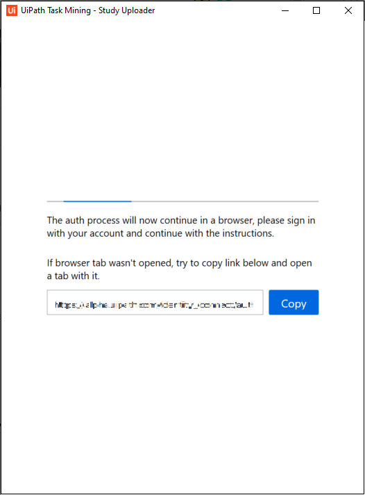

Your system default web browser opens to complete the Cloud sign-in.
If the browser does not open, copy/paste the URL displayed in the Uploader into your browser.

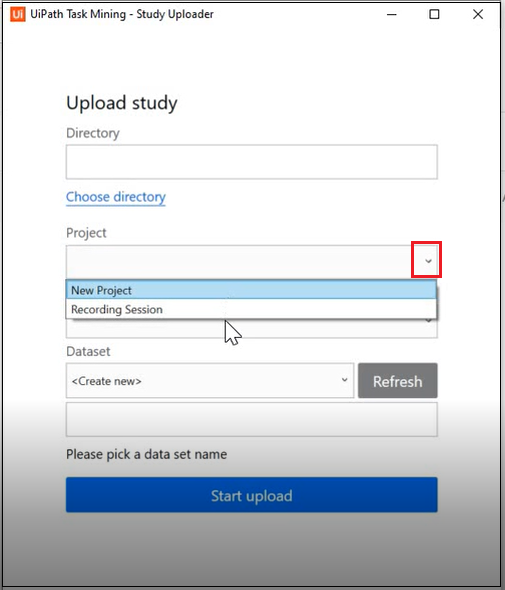

4. If your organization contains several tenants, select the tenant where Task Mining and AI Center™ services are enabled.

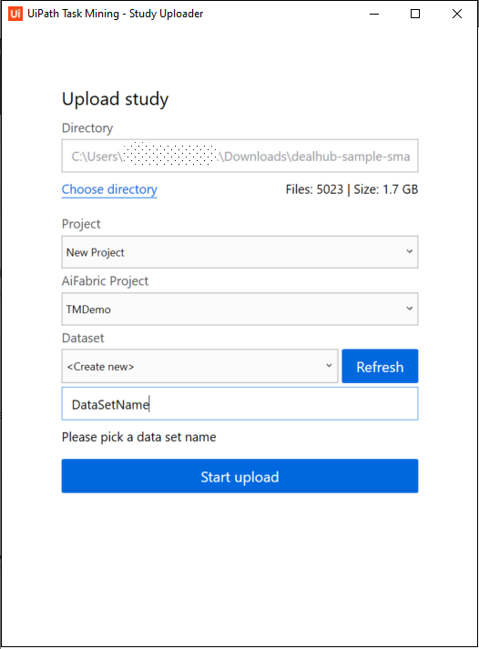

5. Select the Project you created in AI Center™.
6. Select the following details related to your project:
- the name of the project you created in the Task Mining instance;
- the name of the project you created in AI Center™;
- the name of the Dataset created for the AI Center™ project.
Select Start upload.

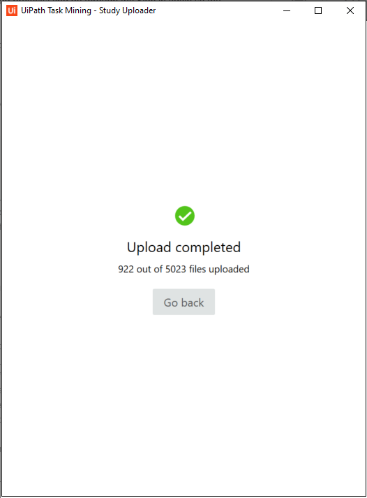

Wait for the files to be transferred.
Once all the files are uploaded a confirmation message is displayed. Close the window.
Important:For the analysis to work, it's very important to keep the files as they are and not to change them in any way, not even zipping them again.

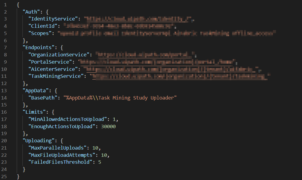

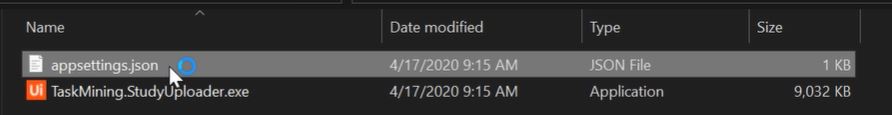

Details about the JSON file
The JSON file contained in the ZIP along the StudyUploader executable contains its configuration and application data path to write logs.
Auth and Endpoints sections of the JSON file should not be modified in any way.
In the JSON file you can find the default path to write application logs: %AppData%\Task Mining Study Uploader
The Limits section sets the minimum and maximum threshold of how many files (user actions) should be uploaded in a single upload run.
The Uploading section sets how many files could be uploaded simultaneously (MaxParallelUploads), how many times a single file that has failed to upload will be attempted to be uploaded again (MaxFileUploadAttempts), and how many files could be skipped during the upload once they reach the *MaxFileUploadAttempts *before the uploader application would throw an error (FailedFilesThreshold).
You can modify the *MaxParallelUploads *parameter to control the network bandwidth used by the Uploader app. Lowering this number could improve the OS performance during the upload but will slow down the upload process. Increasing the number could speedup the upload when a fast network connection is available.
Uploader application requires a minimum of 8 Mbps internet connection speed, >40 Mbps recommended.

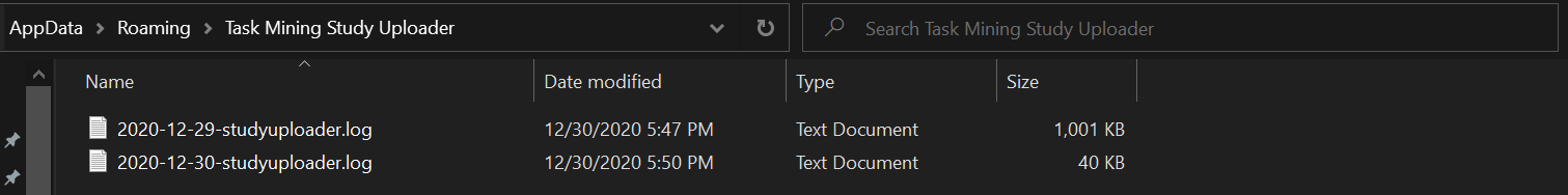

Logs and troubleshooting
You can find details about the upload process in the application logs. After the first application execution, the logs are created in the AppData directory of the user who launched it:
C:\Users{username}\AppData\Roaming\Task Mining Study Uploader or copy and paste the following path into the File Explorer: %AppData%\Task Mining Study Uploader
In case of any issues with the Uploader, share the logs folder content with the support team.
