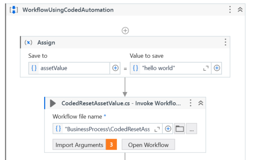

  3. Add an Assign activity and assign a value to the assetValue variable.
  4. Add an Invoke Workflow File activity and invoke the CodedResetAssetValue.cs coded automation. Add the required arguments.
    Note:
    For Windows projects: In the Invoke Workflow File activity, select Browse for File and change the file extensions you're browsing for, from Workflow Files (*.xaml, *.uiwf) to All Files (*.*). This allows you to view all files, including .cs.

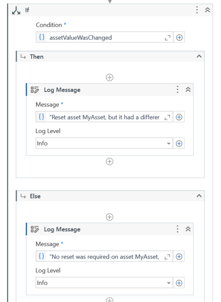

  5. Add an If activity, and log messages for the scenarios where an asset value remains unchanged, and for the scenario where an asset value is updated.
