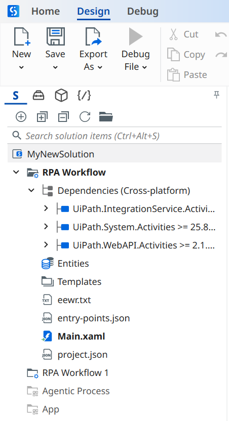

The Explorer panel​
The Explorer panel allows you to manage the projects in your solution, as well as the project files in each project.
Inside the Explorer panel, you can:
  • Use the Add to Solution Add to Solution button to open a menu with two sections:
    • Add to Solution - Add a project to your solution:
      • Create a new automation project.
      • Use Automation from Template to create an automation project from a template.
      • Create a new Maestro Flow or Maestro Automate project.
      • Import an existing automation project.
    • Add to Project - Add a new item to the current project:
      • A folder or a file.
      • A workflow file: sequence, flowchart, long running workflow, or state machine.
      • A form, a coded workflow, a coded test case, or a code source file.
      • A test case or a global handler.
      Note:
      You can also access the Add to Solution window from the context menu of the Solution panel.
  • Use the Search Search bar to find specific projects, files, pages, actions, variables, or arguments in your solution.
  • Open the context menu of the solution to rename it, open it in Studio Web, or, for an empty solution, add a project — the same options offered by the Add to Solution button.
  • Open the context menu of the solution and select Automation from Template to add a project based on a template. For more information, refer to Creating a project from a template.
  • Open the context menu of the solution or a folder and select Add > Folder... to group projects into folders. For more information, refer to Organizing projects into folders.
  • Open the context menu of a project to:
    • Open the project in Studio and access the context menu for projects with project-specific options.
    • Open the project in Studio Web in a new browser tab.
    • Add files and folders to the project, or open its folder with Open Project Folder. These options are available for every project type in the solution. Projects that aren't active offer only Add > Folder... and File..., while the active project offers the full project menu.
    • Remove the project from the solution.
When you open a solution in Studio, you can only make changes to the following project types:
  • RPA projects
  • Maestro Flow and Maestro Automate projects
  • Data Fabric entity projects, which you edit with the UiPath Maestro extension
Other project types included in a solution cannot be modified from Studio and require you to continue editing the solution in Studio Web (this includes app projects, agentic processes, API projects, and agents).
You can browse those other, unsupported project types in the Solution Explorer alongside RPA and Flow projects. When you open a file from one of them, a contextual banner explains the limited editing experience and provides a link to edit it in Studio Web.
The project list refreshes when another tool, such as the UiPath Maestro extension or uip solution projects add, changes the solution.
