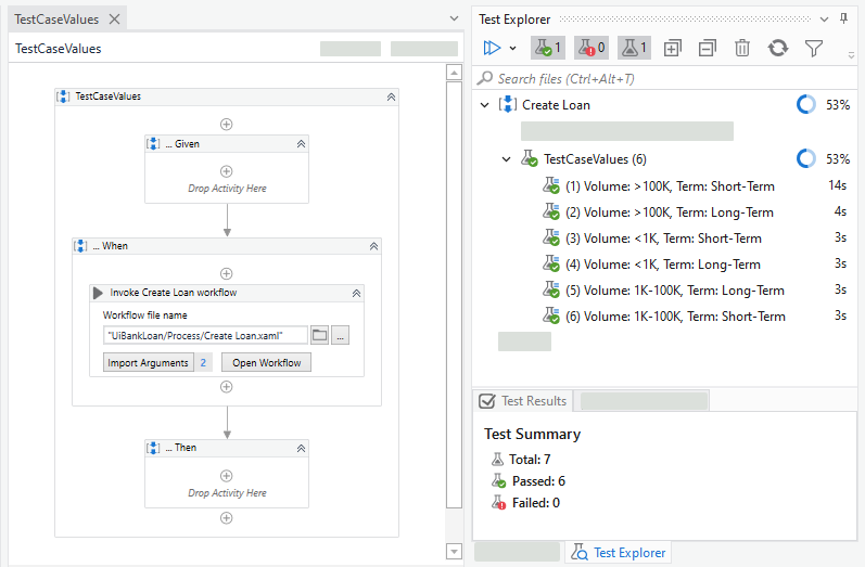

You can use the test results panel for a summary of passed and failed tests.
docs image
Viewing test results in Test Explorer
Click a test run in Test Explorer to view its information in the Test Results panel. On parent test cases, you can see test cases that have passed or failed, whereas for individual test cases you can see information regarding exceptions, and any passed or failed assertions.

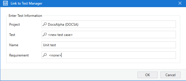

  1. In the Test Results panel, right-click an executed test case and select Upload results to Test Manager. You can select multiple test results that will be added to the test case configured in the following step. You are prompted to configure the Test Manager integration with Studio if it's not yet configured.
    docs image
  2. Configure test information to link the test result to the relevant Test Manager objects.
    docs image
  3. Click Ok to confirm. The results can be seen in Test Manager.
