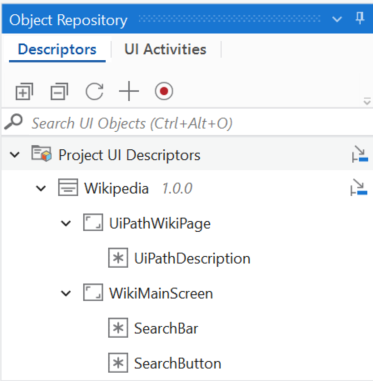

  4. Retrieve the UI elements that you need to automate from Wikipedia. Go to the Object Repository tab and create an application named Wikipedia.
  5. Create two screens for the Wikipedia application:
    1. WikiMainScreen – the landing page where you perform the search. For this screen create two elements:
      • SearchBar
      • SearchButton
    2. UiPathWikiPage – the resulting Wikipedia article about UiPath. For this screen, create the UiPathDescription element, which indicates the first paragraph in the article.

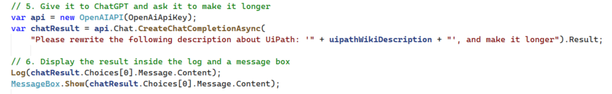

  10. Send the description to ChatGPT using your OpenAI account
    1. Create a variable named api to initialize your OpenAI account that you can access using the provided API key. Use the following variable:
      var api = new OpenAIAPI(OpenAiApiKey);
    2. Create a variable named chatResult, where you initialize the new chat and sent a prompt to ChatGPT. Use the following code:
      var chatResult = api.Chat.CreateChatCompletionAsync("Please rewrite the following description about UiPath: '" + uipathWikiDescription + "', and make it longer").Result;
  11. Display Chat GPT’s response inside a message box, using the following expression:
    MessageBox.Show(chatResult.Choices[0].Message.Content);
