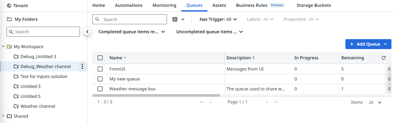

For resources that are automatically created when initiating the debugging session, a debug folder is also automatically created in your Personal Workspace in Orchestrator. The new Orchestrator folder is named Debug_[Name of the Solution].

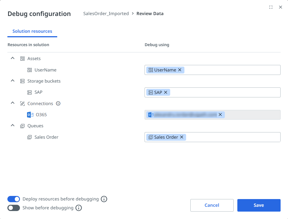

The Debug configuration window
The Debug configuration window gives you access to resources used during the debugging process, as well as input arguments found in the solution.
To access the Debug configuration window:
  1. Navigate to the toolbar above the Studio Web designer.
  2. Select the docs image arrow next to the debugging environment.
  3. Select Debug configuration from the drop-down menu.
Resource categories are grouped under the Solution resources tab. You can expand each category to see individual resources.
Under the Debug using column, a message inside the search bar informs you that resources are deployed in the debug folder.
To choose which resource is used during debugging, click inside the search bar and choose a resource available in the solution or in the UiPath PlatformTM. Platform resources are selected by default and can be removed by selecting the Remove icon next to the resource name.
Available input arguments appear under the Entrypoint arguments tab. You can set argument values directly in the default view or you can switch to the code editor from the docs image button.
Inside the Debug configuration window, you can also enable:
  • The Deploy resources before debugging option, to speed up the debugging process by provisioning resources only for the current project. If the option is not enabled, no resources are deployed.
  • The Show before debugging option, to make the window appear when you start a debugging session.
