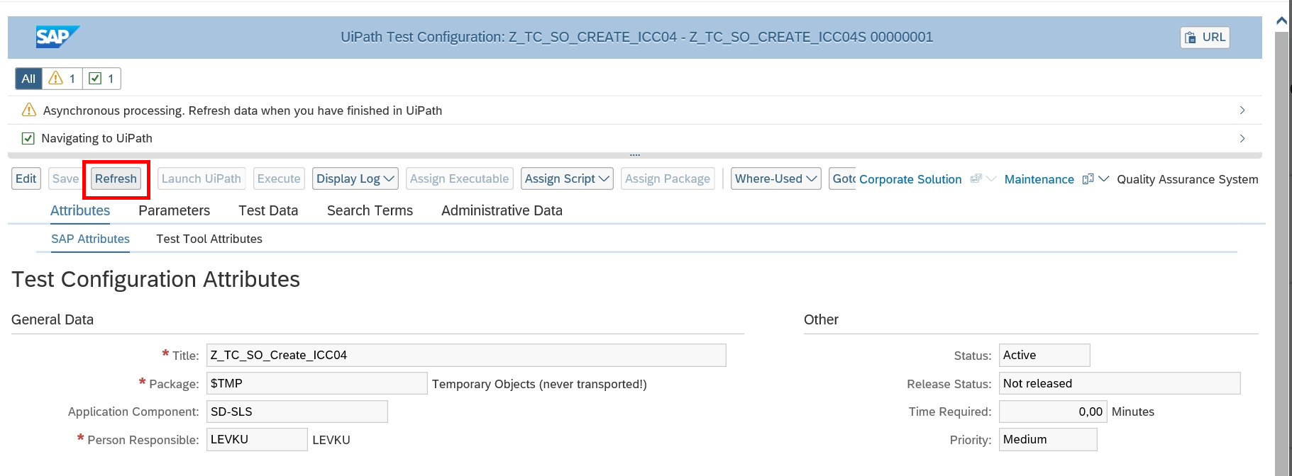

  7. Click Refresh to update the data in the Test Configuration.
  8. Click Close in the Test Configuration window to complete the creation process.
    The test case is assigned to the solution documentation and its corresponding transaction.
