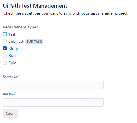

Configure Jira Project
  1. Open Jira and navigate to the project you want to integrate with Test Manager.
  2. Switch to the project settings.
  3. Scroll down and select UiPath Test Manager to open the Test Manager configuration page.
  4. Select all Jira issue types that you want to be synchronized as requirements to Test Manager.
  5. Enter the Server URL from Test Manager (e.g., https:/.uipath.com/companyName/tenantName/testmanager_/).
  6. Paste the API Key you copied at step 7 from the previous procedure.
  7. Click Save.
