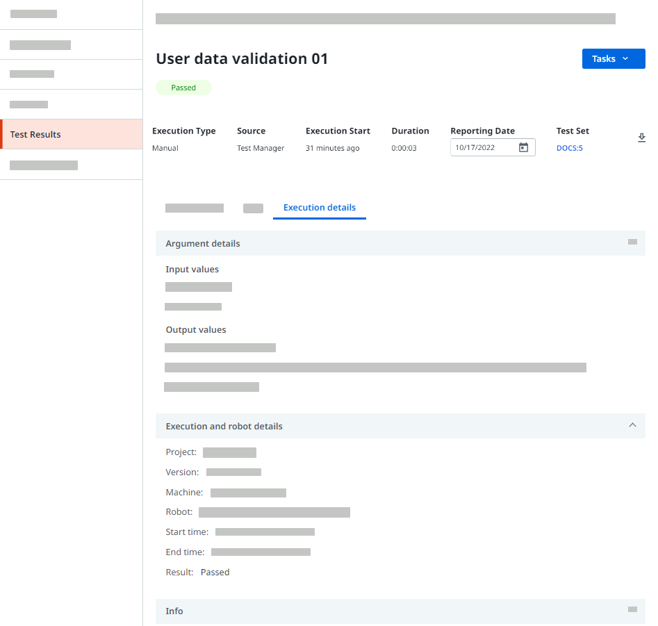

Execution log
As part of test reporting, execution logs hold information such as execution details (e.g., data variation and screenshots), failed and passed assertions, and a detailed log of execution events.
To open a test case log, go to Test Results, open a test execution and then click a test case Key.
In the following table, you can view the type of information that is collected during test case execution.

Execution details |
View argument details such as input and output values, as well as execution and robot details (e.g., project, machine, robot). |
