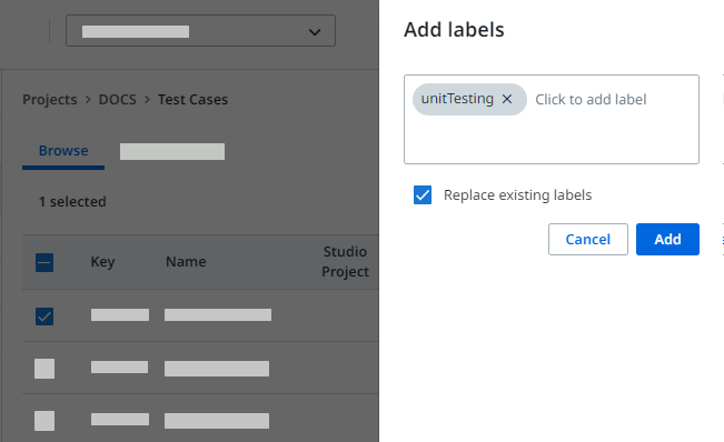

Adding Labels
  1. Log in to Test Manager and navigate to either Requirements,Test Cases, or Test Sets.
  2. Select the objects for which you want to add a label and click Edit labels in the action panel. Alternatively, you can select the checkbox in the column header to select all objects.
  3. Select Add labels and enter a new label in the form field.
  4. Press Enter to add the label. You can add multiple labels at once.
  5. (Optional) You can type in labels that have been already created to open the dropdown list. The list shows the matches from the labels created for all other objects in the current project.
  6. (Optional) Select Replace existing labels if you want to substitute all existing labels with new ones. System-assigned labels, if any, will not be substituted.
  7. Click Add to confirm your action. Labels will be added to selected objects.
