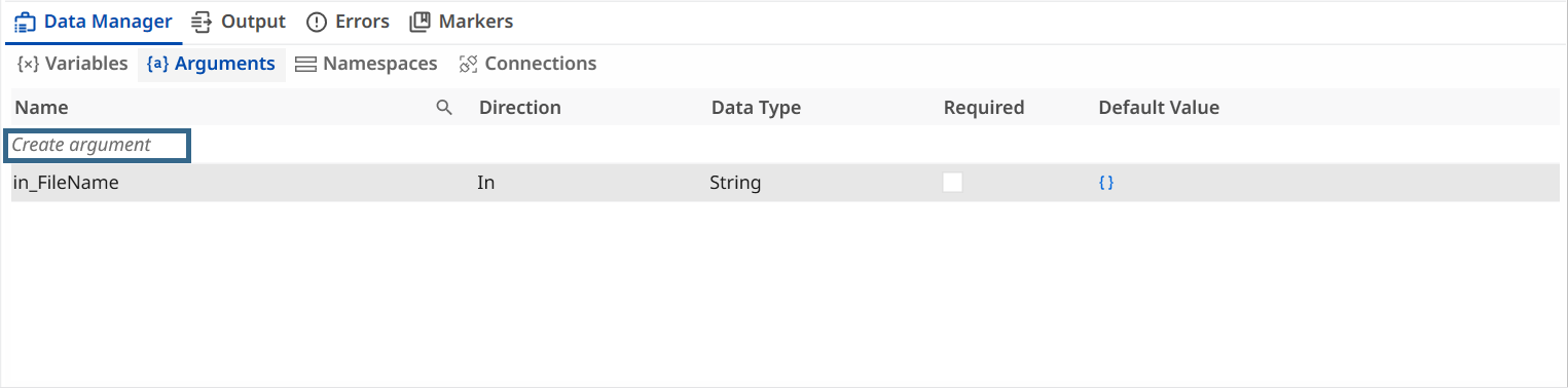

From the Data Manager
docs image
  1. Open the Data Manager.
  2. Navigate to the Arguments panel,
  3. Select the Create argument line. A new argument is created.
    Note:
    By default, all arguments are of String type and have an In direction.
  4. Configure the created argument:
    • Select the argument name to edit its name.
    • Expand the argument using the arrow to its left, and set the Direction, Data Type, whether it is Required, and optionally, the Default Value.
