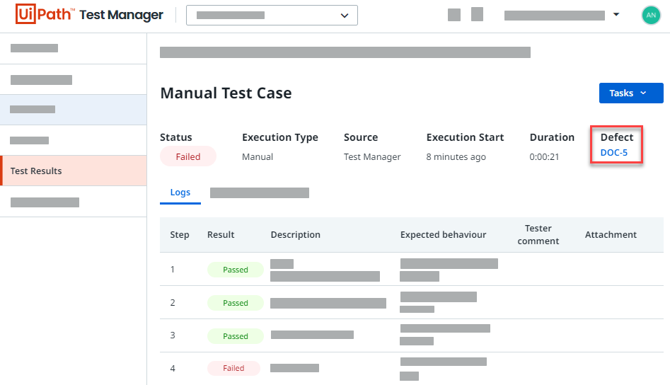

Create defects from results​
You can create defect reports including the execution log to your external defect management system, if you already have it integrated with Test Manager. For more information, see ALM Tool Integration.
To create a defect out of an execution log, you need to open a test case log, click Tasks, and then select Create Defect. After the defect has been created, a link is available in the execution log, so you can access the integrated external tool.

Create defect​
You can create defects when you access test case logs in the Test Results page.
  1. Navigate to Test Results
  2. Open a test result and the click the test case key to open the logs.
  3. Click Tasks and select Create Defect.
The defect is created and synchronized with your external tool. You can open the defect directly in the tool (e.g., Atlassian Jira) by navigating to the test execution result that has a synchronized defect.
