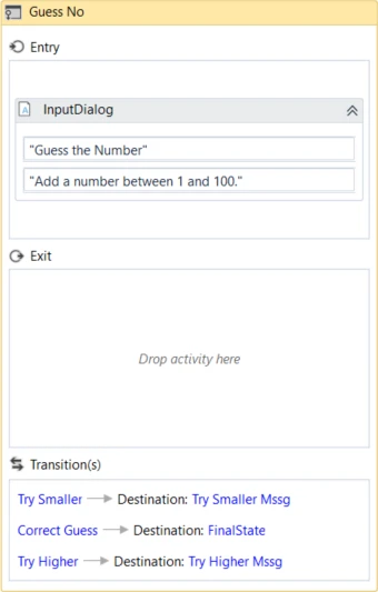

The State activity contains three sections, Entry, Exit and Transition(s), while the Final State only contains one section, Entry. Both of these activities can be expanded by double-clicking them, to view more information and edit them.
The Entry and Exit sections enable you to add entry and exit triggers for the selected state, while the Transition(s) section displays all the transitions linked to the selected state.

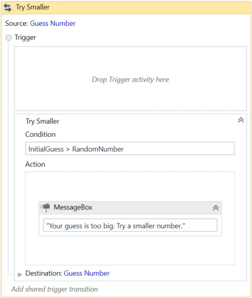

Transitions are expanded when you double-click them, just like the State activity. They contain three sections, Trigger, Condition and Action, that enable you to add a trigger for the next state, or add a condition under which an activity or sequence is to be executed.

In the Entry section, add an Input Dialog activity.
Select the Input Dialog, and in the Properties panel, add an appropriate Label and Title to prompt the user to guess a number between 1 and 100.
In the Result field, add the
InitialGuessvariable. This variable stores the user’s guess. -
Return to the main project view and create a transition that points from the Guess Number state to itself.
Double-click the transition. The transition is displayed expanded in the Designer panel.
In the Properties panel, in the DisplayName field, type Try Smaller. This message is displayed on the arrow, enabling you to run through your automation easier.
In the Condition section, type
InitialGuess>RandomNumber. This verifies if the user’s guess is bigger than the random number. -
In the Action section, add a Message Box activity.
In the Text field, type something similar to "Your guess is too big. Try a smaller number." This message is displayed when the user’s guess is bigger than the random number.
