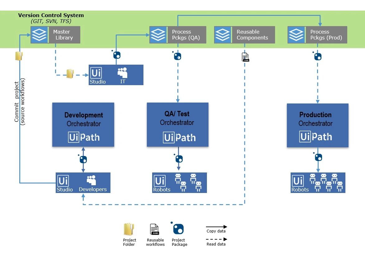

There are various ways of designing the architecture and release flow, considering the infrastructure setup, concerns about the segregation of roles, etc.
In this proposed model UiPath developers can build their projects and test them on Development environments in Orchestrator. They are allowed to check in the project to a drive managed by a version control system (VCS), such as GIT, SVN, or TFS.
Publishing the package and making it available for Test and Production environments is the work of a different team, such as IT.
The deployment paths on Orchestrator have been changed from their default to folders managed by the VCS, by changing the Storage.Location value in the UiPath.Orchestrator.dll.config file in the Deployment section..
The model also contains a repository of reusable components.
Here is the project publishing flow, step by step:
- Developers build the process, test & debug pieces of it locally (Studio).
- Once the automation development is completed, the process is published to the Development Orchestrator and tested again end-to-end.
- The project folder is committed (not packaged) to a Master Library folder (on VCS).
- The IT/ RPA Operations team creates the project package for QA. This step is intended to be an additional safety measure: the automation source code is inspected (by a different entity) before being packaged and run by robots.For example, the packaged process is stored in the Process Pckgs (QA) folder on VCS, from which it is deployed to the QA robots and executed.
- If any issue is revealed during the tests, the steps above are repeated.
- Once all QA tests are passed, the package is pushed to a Production environment - Process Pckgs (Prod).
- When the Process goes live, the process package is deployed to the production Robots and executed.
Reusable Content is created and deployed separately, as UiPath code (Reusable Code Library) and Invokes (Invokes Repository).

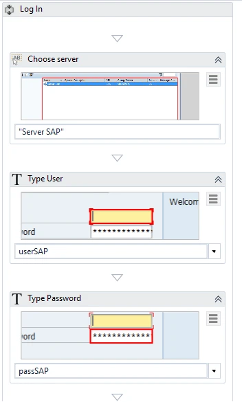

Workflows with source code are .xaml files containing activities for automating common processes, such as Log in to SAP:
Invokes represent workflows composed only of one Invoke activity of the code workflows mentioned above.
The Snippet panel of a Studio developer should point to this Invoke repository in order to provide easy access (drag & drop) to Reusable Content.
The local design authority in charge with maintaining the Reusable Content updates (due to a change in process, for instance) the workflows with code. The Invokes remain unchanged.
The advantage of this approach (as opposed to working directly with the library of source code) is that when a change is done to a reusable component, all the running projects reflect this change as well, as they only contain an Invoke of the changed workflow.

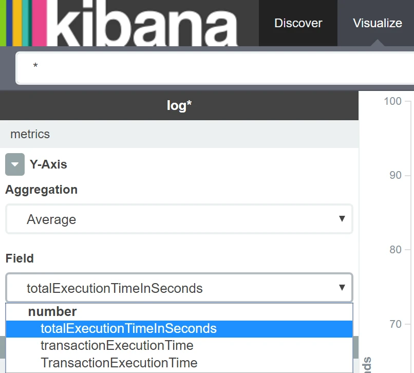

Custom Log Fields
To make data easily available in Kibana for reporting purposes, the Robot may tag log messages with extra values using the Add Log Fields activity. By default, any UiPath log output has several fields already, including message, timestamp, level, processName, fileName, and the Robot’s Windows Identity. Log Fields are persistent so if we do not need to mark all messages with a tag, fields should be removed immediately after logging, using the Remove Log Fields activity. Do not use a field name that already exists. It’s important to specify the proper type of argument the first time when you add the field. This is how Elasticsearch indexes it.
