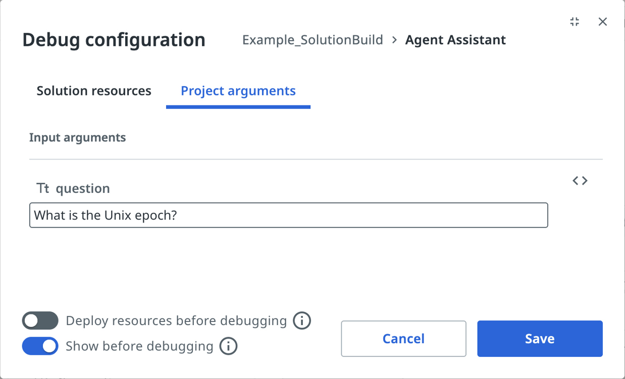

You start by debugging the agent first (the Deploy resources before debugging option in the Debug configuration window is disabled):
docs image
The agent runs successfully in debugging, as expected:

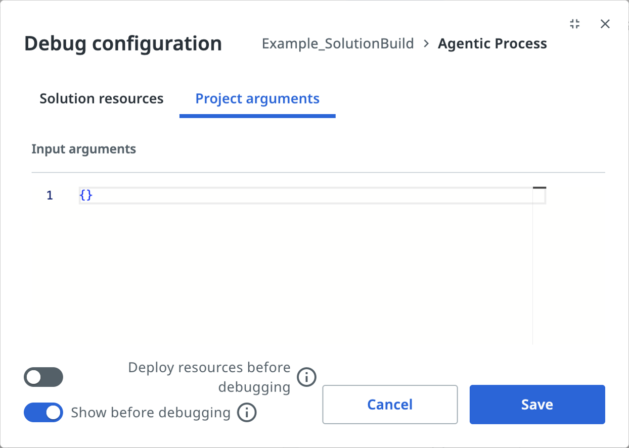

Next, you want to debug the agentic process that calls the agent (again, the Deploy resources before debugging option is disabled):
docs image

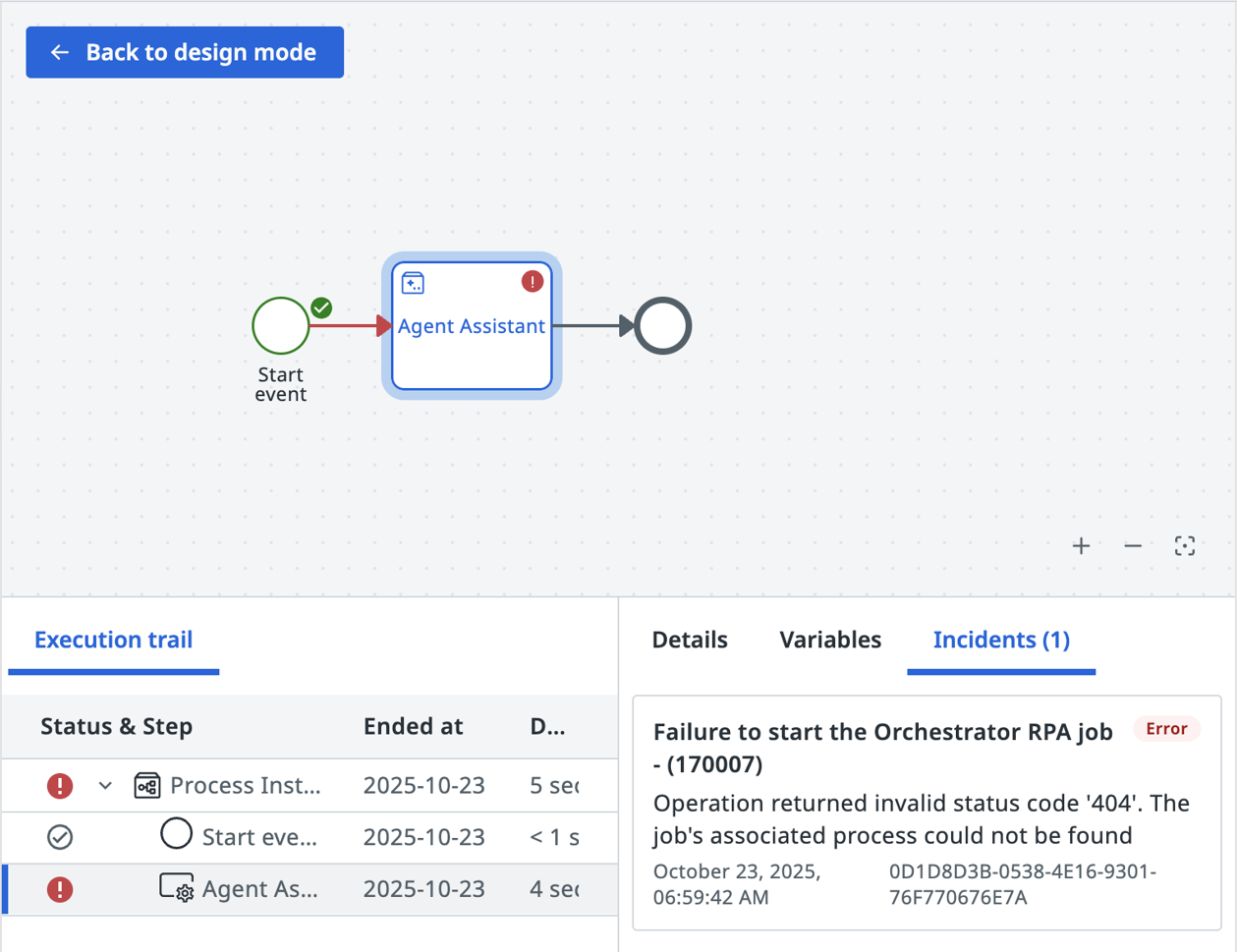

Unfortunately, an error appears in the agentic process. Why does this happen?
docs image
The error occurs because when you debug a project, it is not deployed anywhere. The project runs directly in a "Studio Web Debugging" job. In this case, since you debugged each project individually with the Deploy resources before debugging option disabled, neither project was ever deployed to any folder.
The Output panel offers this explanation:

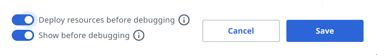

  1. Enable the Deploy resources before debugging option in the Debug configuration window to deploy the latest resources to your personal workspace:

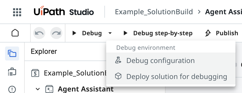

  2. Navigate to Debug > Deploy Project for Debugging. This will deploy all projects to your personal workspace so they can be referenced by other projects (such as the agentic process) during debugging.
    docs image
