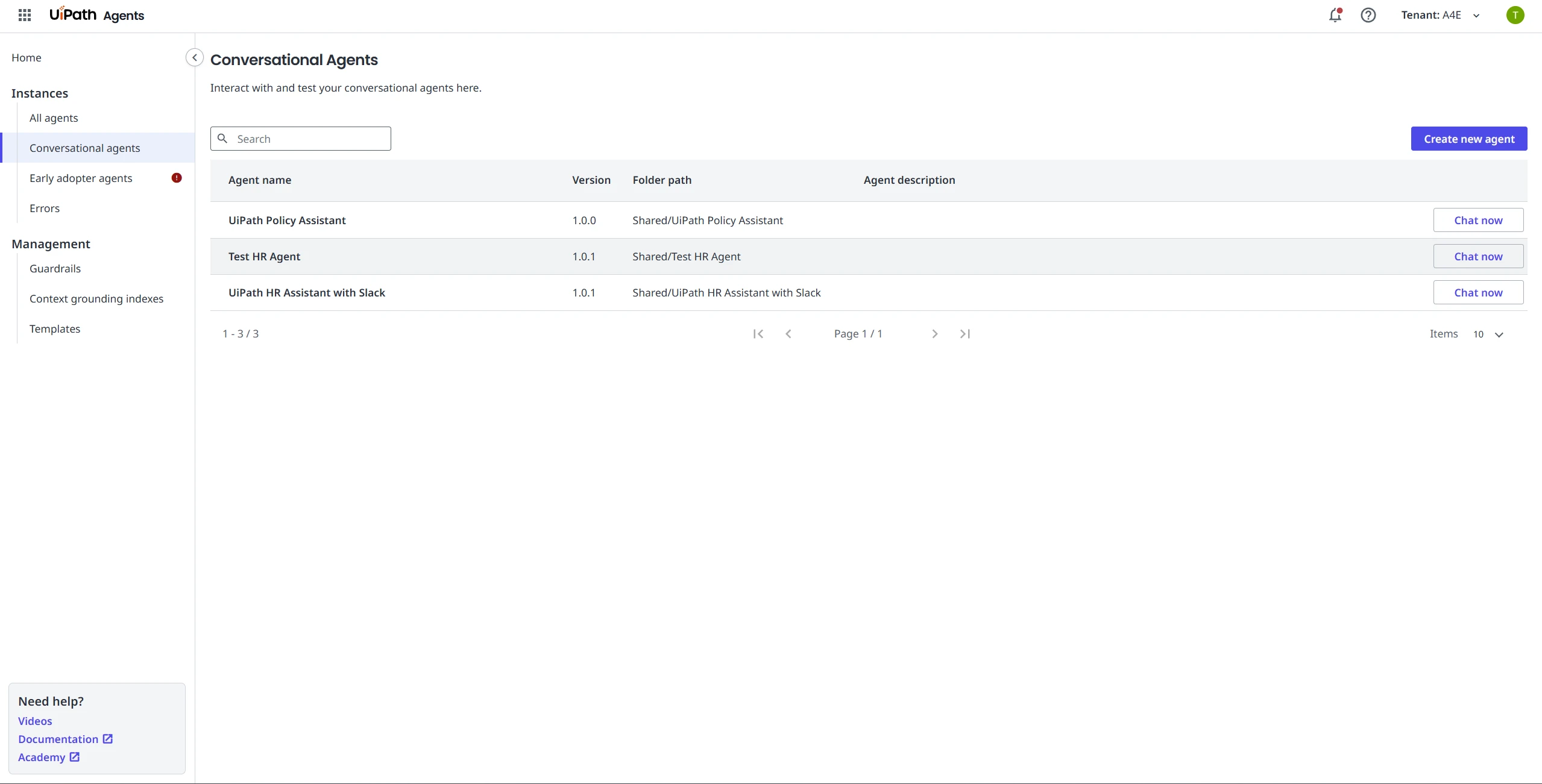

Step 6: Access your agent
After publishing, you can interact with your agent in several ways:
  1. Instance Management: Go to Agents > Deployed agents in Automation Cloud and select Chat on your Conversational agent.
  2. Autopilot for Everyone: Access your agent from the Autopilot picker dropdown.
  3. Teams or Slack: If configured, interact with your agent through the Autopilot plug-in.
Instance Management
