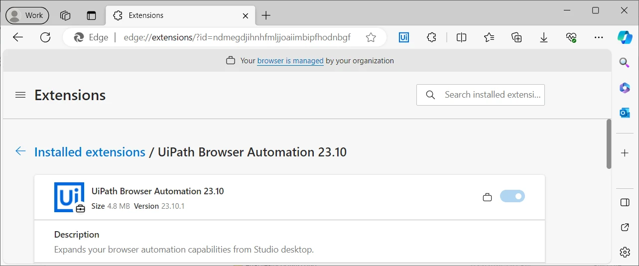

Check if the Extension for Microsoft Edge is installed and enabled
- In Microsoft Edge, navigate to
edge://extensions/. - Make sure the extension is installed and enabled, as explained here.
- If the extension was installed correctly but does not appear in Microsoft Edge, check if there are Group Policies that affect the extension, as explained here.

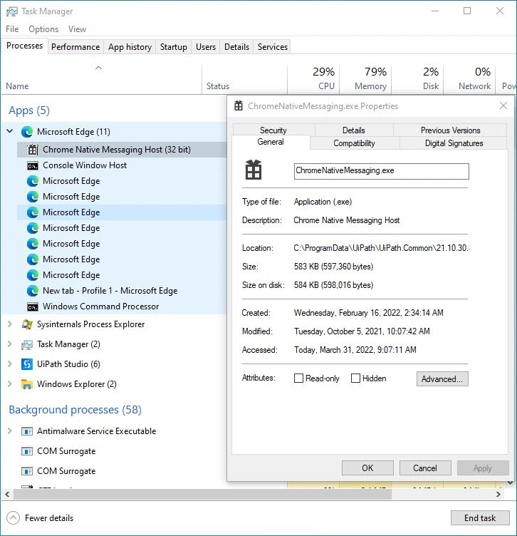

Check If ChromeNativeMessaging.exe Is Running
The ChromeNativeMessaging.exe enables communication between the UiPath Extension for Edge and the UiPath Studio/Robot.
Open Microsoft Edge.
Open Task Manager.
Check if the
ChromeNativeMessaging.exeprocess is running. -
If the process is not running:

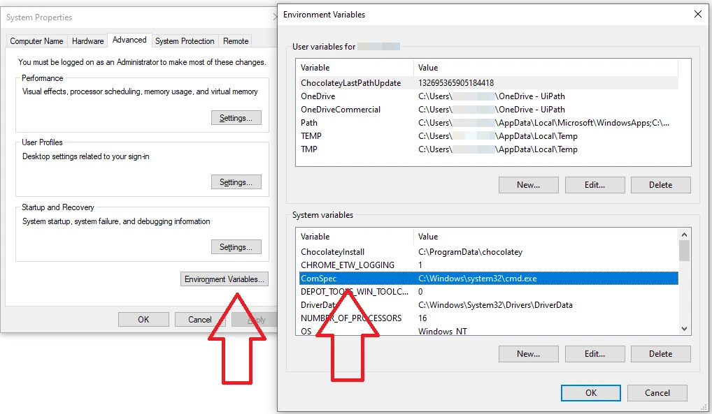

Check if ComSpec variable is defined correctly
Description
The ChromeNativeMessaging.exe process runs under the current user and it uses cmd.exe to start the browser.
If the ComSpec environment variable is missing or has an invalid value, then Microsoft Edge cannot launch the ChromeNativeMessaging.exe.
Furthermore, the administrator may disable the command prompt for some users or configure it to always run with elevated privileges.
Solution
Manually add the correct value for the ComSpec environment variable. This variable is set at Windows installation and must be set to: %SystemRoot%\system32\cmd.exe.

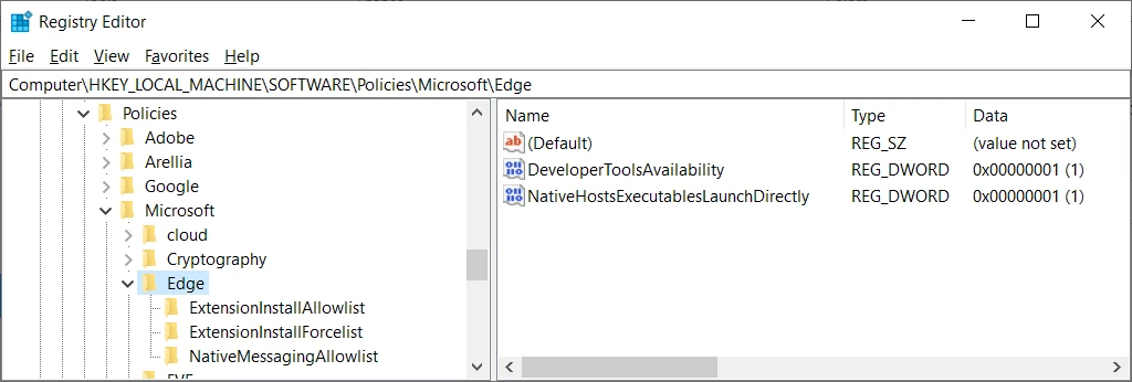

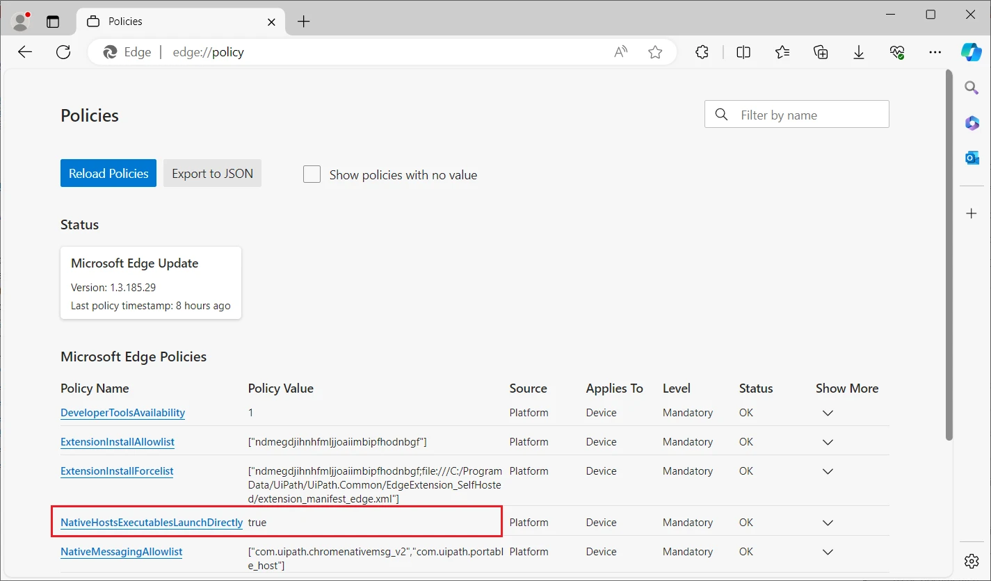

Other workarounds
If the ComSpec environment variable is set correctly but the problem persists, the user may not have permission to run the command prompt. In this case, the ChromeNativeMessaging.exe process cannot be started with cmd.exe running under the current user.
Starting with Chromium 120.0.6090+, a NativeHostsExecutablesLaunchDirectly Group Policy allows admins to turn this on for users in restricted environments (Cloud PCs that forbid cmd.exe, for example).

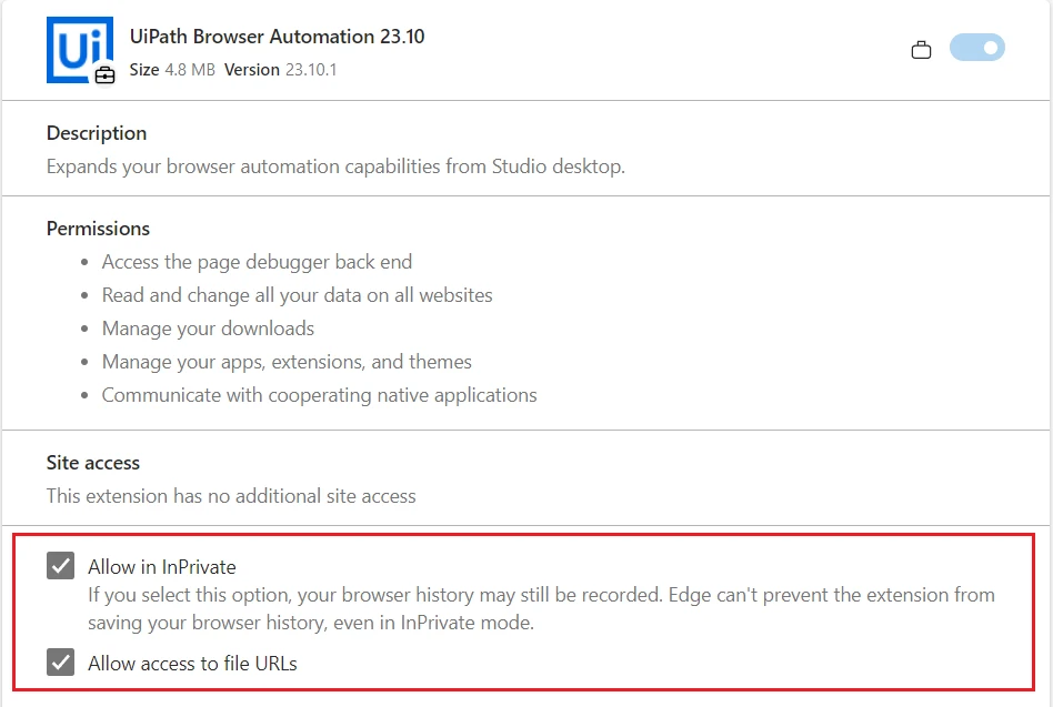

Enable access to file URLs and InPrivate mode
By default, the extension is not granted access to File URLs or InPrivate mode. To enable these:
edge://extensions/. The Microsoft Edge Extensions page is displayed. -
Navigate to the UiPath Browser Automation extension and click the Details button.
Make sure the Allow in InPrivate and Allow access to file URLs options are selected.

The DeveloperToolsAvailability Group Policy value must be set to 1
The DeveloperToolsAvailability has the following possible values:
- 0 = Disallow usage of the Developer Tools on extensions installed by enterprise policy, allow usage of the Developer Tools in other contexts
- 1 = Allow usage of the Developer Tools
- 2 = Disallow usage of the Developer Tools
If the UiPath Extension for Edge is installed using Group Policy, then the DeveloperToolsAvailability must be set to 1 to enable the full functionality of the extension.
This value is automatically set correctly when the extension is installed but it will be overwritten if your system administrator has set another value for this policy.
The other values for DeveloperToolsAvailability cause the problems listed below.
If DeveloperToolsAvailability is set to 0 then:
- The UiPath Extension for Edge will be restricting to working with LTS versions of UiAutomation (19.10.x, 20.10.x, 21.10.x, 22.4.x)
- The
InjectJSActivity will not work.
If DeveloperToolsAvailability is set to 2 then:
- All the limitations from
DeveloperToolsAvailability=0apply - The
ChromiumAPIinput method will not work.

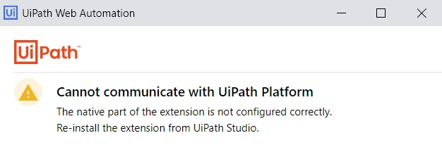

The UiPath Web Automation browser window shows a warning
The UiPath Web Automation browser window shows the following warning if ChromeNativeMessaging.exe could not be started:
Cannot communicate with UiPath Platform The native part of the extension is not configured correctly.
Re-install the extension from UiPath Studio.
