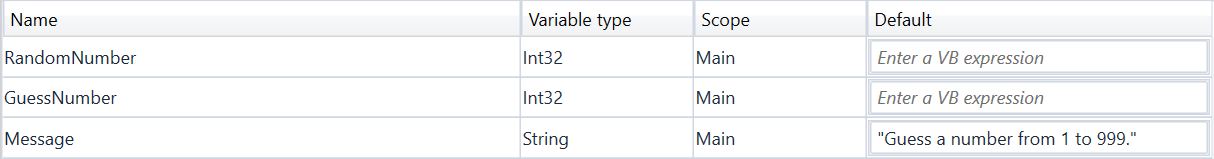

  3. Create two Int32 variables (RandomNumber, GuessNumber) and a String one (Message).
  4. Set the default value of the Message variable to "Guess a number from 1 to 999." The RandomNumber stores a random number between 1 and 999, GuessNumber stores the user’s guess and Message stores the message that is going to be displayed to prompt the user.

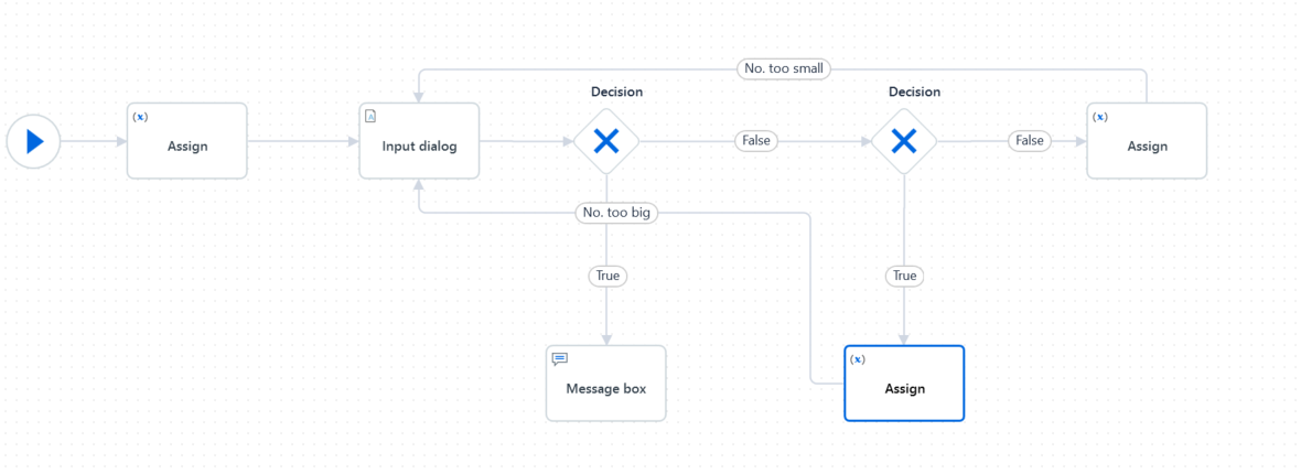

  23. Connect the Assign activities created at steps 18-22 to the Input Dialog. A loop is created, asking the user to type a smaller or bigger number, until he guesses correctly. Optionally, you can add labels by right-clicking a connection and selecting Add label.
The final project should look as in the screenshot below.
docs image
