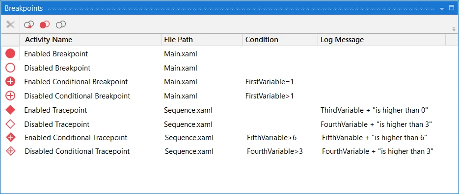

Each breakpoint or tracepoint receives a specific icon based on its state. The icon is set on the activity and visible in the Breakpoints panel.
Type Description
Breakpoints
Breakpoints pause the debugging process before the activity is executed. Breakpoints can have the following states:
  • Enabled - docs image
  • Disabled - docs image
Conditional Breakpoints
Conditional breakpoints are breakpoints that depend on a set condition and/or a hit count. Conditional breakpoints can have the following states:
Tracepoints
Tracepoints are breakpoints with set logged messages. When the tracepoint is reached during debugging, the message is logged at trace level. Tracepoints can have the following states:
Conditional Tracepoints
Conditional tracepoints have a set condition or hit count, and a logged message. The message is logged when the condition is met the number of times stated in the hit count field. Conditional tracepoints can have the following states:

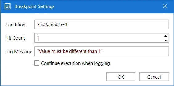

Breakpoint Settings​
The Breakpoints panel comes with a set of settings that can be individually adjusted for each toggled breakpoint part of the automation project. Click the docs image icon to open the window.
Note:
Please take into consideration that any expression added in the Condition field is not validated.
Field Descriptions for Breakpoint Settings​
The Breakpoint Settings window has the following options:
OptionDescription
ConditionThe condition for the breakpoint. If the condition is met during debugging, the execution breaks and the activity is highlighted.
Hit CountSpecifies the number of times the condition must be met before the execution breaks. If the hit count is higher than the number of times the condition can be met, the execution does not stop upon encountering the breakpoint. The maximum hit count value is 32,767.
Log MessageSpecifies the message to be logged at trace level when the condition is met. The message is visible in the Output panel. If a condition is not set, the message is still logged.
Continue execution when loggingIf selected, the execution is not paused when the condition is met and the specified message is logged. Available only if a log message was previously set.
Settings for any breakpoint in the project are visible upon hovering the breakpoint in the Designer panel.

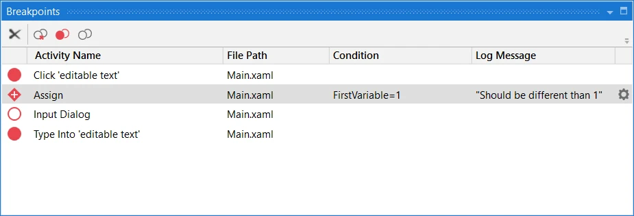

The Breakpoints Panel​
The Breakpoints panel displays all breakpoints in the current project, together with the file in which they are contained. The Activity Name column shows the activity with the toggled breakpoint, while the File Path column displays the file and its location.
The Condition column displays conditions set to breakpoints. The Log Message column shows messages to be logged if the condition is met. Hover over the breakpoint tag on an activity to view its condition and log message.
Double-click on a breakpoint to see the activity highlighted in the Designer panel. Use context menu options or the Breakpoints button in the ribbon to enable or disable breakpoints.
To delete multiple breakpoints, select them and click Delete in the context menu, or the Delete button in the panel. This removes the breakpoints from the current file.
The Delete all, Enable all and Disable all breakpoints buttons perform actions on all breakpoints listed in the panel, regardless if they are selected or not.
