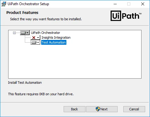

2. Install and enable Test Automation
You can enable the Test Automation module when you install or upgrade Orchestrator. When you reach UiPath Orchestrator Setup select Test Automation.
Additionally, you can perform the following steps for enabling the Test Automation feature in Orchestrator, based on the installation type:
  • For MSI intallations:
    1. On the Orchestrator web application server, navigate to Control panel, and then Programs.
    2. Select Orchestrator, and then click Change.
    3. Select Test Automation.
      A pop-up is displayed, where additional steps are described to finalize the action.
    4. Follow the steps from the pop-up to finalize the action.

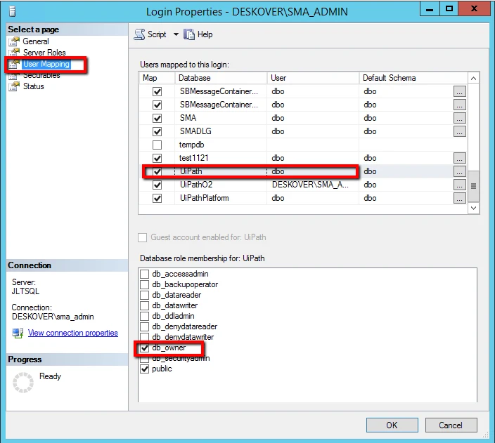

3. Configure SQL server users
Provide the SQL user that you provide in the Authentication Mode field from the Database Settings installation tab, with the necessary rights to create databases. During the installation of Test Manager, a new and dedicated database is created.
Note:
When you enable the Test Automation feature in the Orchestrator, it creates a dedicated database with the default name UiPathTestAutomation. This database differs from the one created during the Test Manager installation.
  • Regardless of the type of user (domain or SQL) you want to connect to SQL Server, please note that you need to assign it thedbcreator Server Role BEFORE installing Test Manager, as the database is created during this installation process.
  • If security restrictions do not allow the use of thedbcreator Server Role in the service account, create the empty database in SQL Server.
    The Windows installer connects to SQL Server to verify the existence of the database.
  • After creating the database, you need to provide the user which connects to the SQL database with the db_owner user mapping role, as in the following screenshot.
