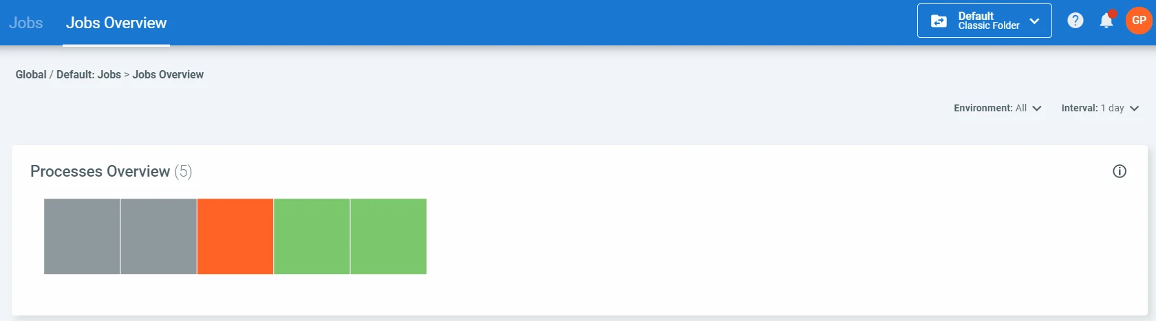

Processes Overview
Enables you to check the status of your jobs and associated processes in real time so you can assess if there are any problems that can impact the entire system. Each color block represents a specific process from your instance. Hovering over a block displays the name of the corresponding process and its containing folder. Note that it is possible to have multiple processes with the same name if each is in a different folder.The total number of processes is displayed in parentheses after the widget name.
Processes are represented with colored blocks as follows:
ColorTooltip
GreenThe process was executed successfully.
If the job was executed successfully at least once, the block keeps its green color regardless of the failed executions.
BlueThe process is currently being executed.
OrangeWaiting for a Robot to connect.
The process is suspended.
RedThe process was executed with errors.
The block keeps its red color if all the associated process executions fail. If the job is successfully executed at least once, the block changes to green.
GreyThe process that was never executed.
As a job's state changes, the chart gets updated and the block color changes accordingly. Hovering over a block displays detailed information on the corresponding process. Clicking the block displays the corresponding detailed view page. Click the arrow at the top-left of the page to return to the general view.
