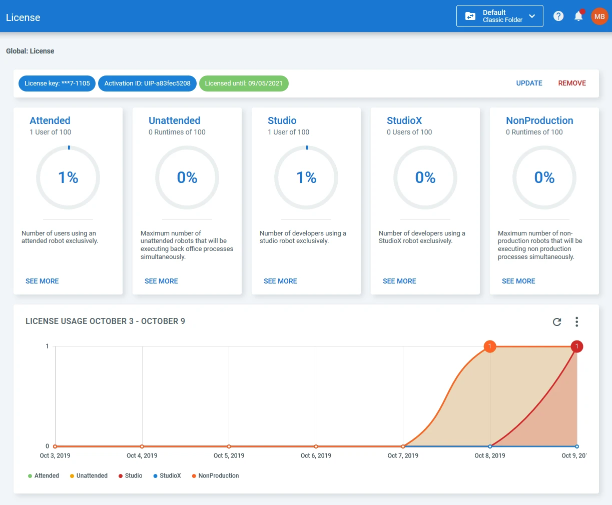

To fast-track your deployment time and easily manage activation from a centralized location, Robot licensing is available in Orchestrator, on a per tenant basis, in the License page. Here you can upload, renew, or remove a license with just a click of the button.
First, you need to activate and upload your license to Orchestrator, as explained here. Afterward, all you need to do to activate a Robot license is to connect it to Orchestrator.

In this model of licensing, we count the maximum number of Unattended/NonProduction Robots that are able to execute processes simultaneously. This number is given by the total number of runtimes allocated to all the online machines. You can distribute the licenses across all your machines.
Please note that it is not possible to allocate more runtimes than there are available. For example, if you have 4 remaining runtimes available, and 2 already allocated to a machine, then you can only allocate a maximum of 6 runtimes to that machine.
In the License page, the total number of runtimes available on all online machines is displayed.
