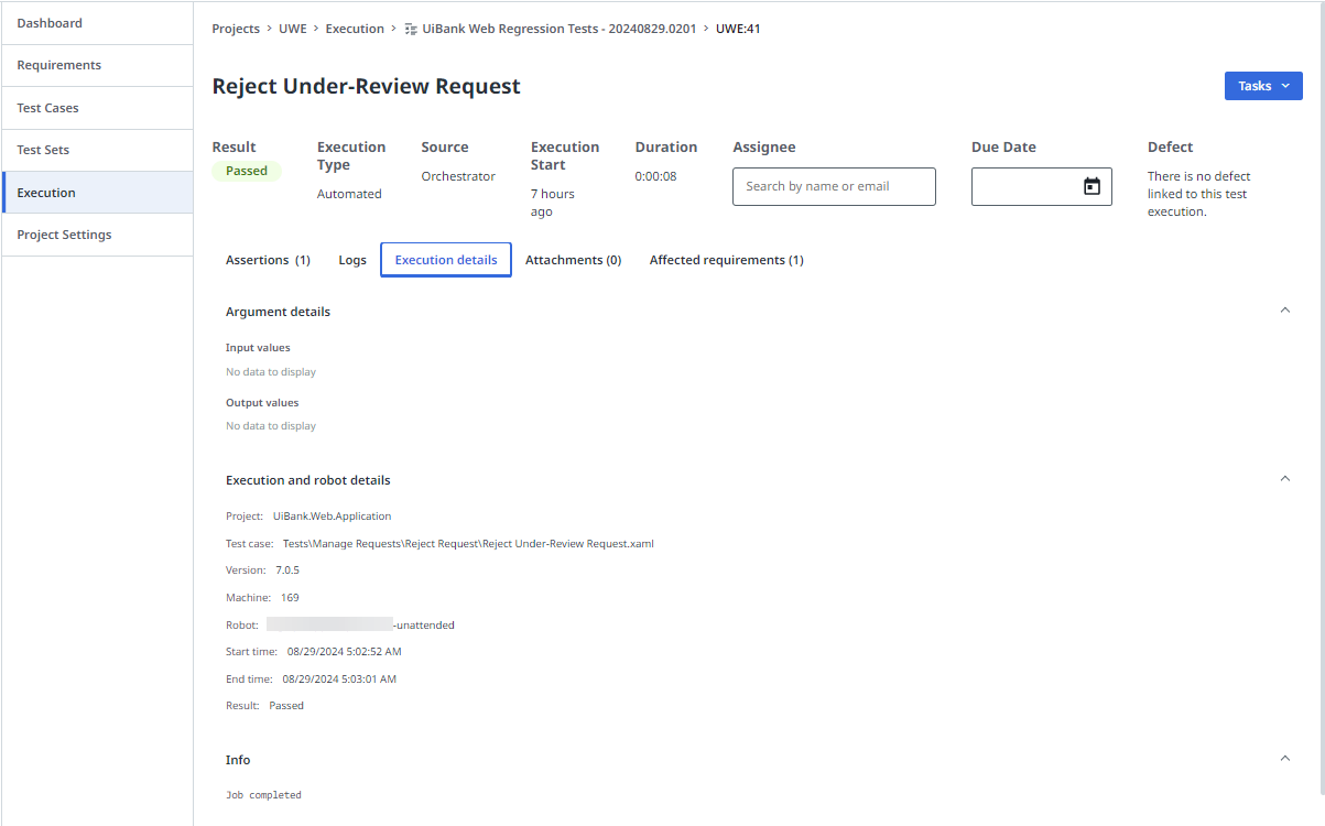

Execution log
As part of test reporting, execution logs hold information such as execution details (e.g., data variation and screenshots), failed and passed assertions, and a detailed log of execution events.
To open a test case log, go to Executions, open a test execution and then click a test case Key.
Figure 3. Overview of the execution details of a test case log
In the following table, you can view the type of information that is collected during test case execution.

Execution details
View argument details such as input and output values, as well as execution and robot details (e.g., project, machine, robot).
