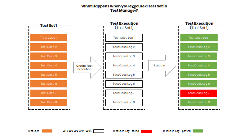

When you start executing a test set, Test Manager goes through the following process:
  1. A Test Execution is created in the Test Results section of Test Manager. This serves as the container for the test results.
  2. For every test case within the executed test set, an empty Test Case Log is generated. This log is attached to the Test Execution and will hold its associated test results.
  3. As the execution continues, the Test Manager fills each Test Case Log with results and related log information.
Note: Every time a test execution is created, Test Case Logs for all associated test cases from the original test set are added. This means existing Test Executions remain consistent, regardless of updates or deletions made to the original test set.
The chart below illustrates the process of executing a test set in Test Manager.
As a consequence, after a test set has been executed, any changes to the test set or its associated test cases do not affect the results from previous executions. Even when a test set is deleted, all the test executions remain unchanged.

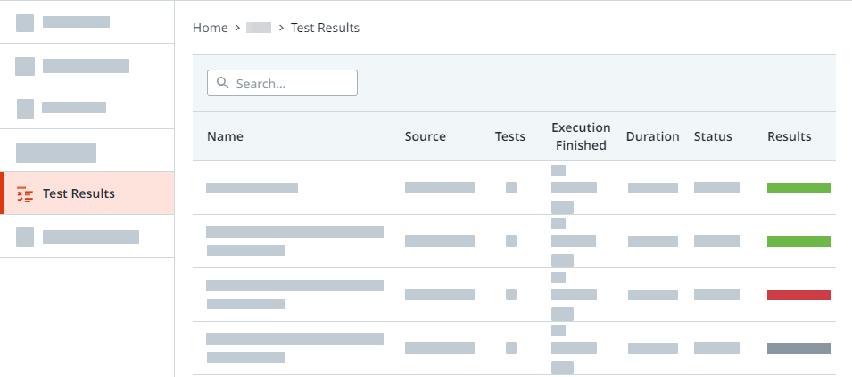

By default, the test executions are sorted based on the date on which the execution was finished. Currently running and pending executions are placed at the top.
You can identify the status through the color codes assigned to each test execution, as follows.:
  • Green:- Test cases that passed.
  • Red: Test cases that failed.
  • Grey: Test cases without a definitive results, such as test cases that have not been executed yet but are part of a test set that is currently being executed.
