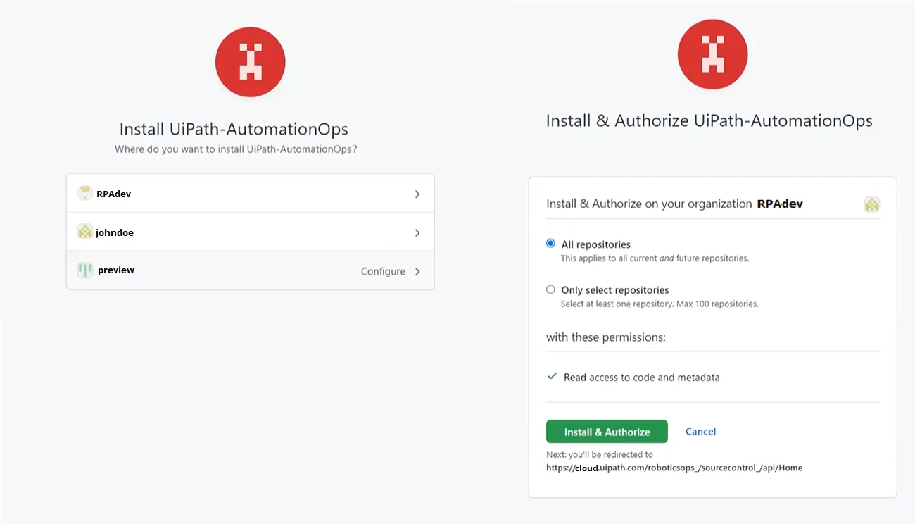

Step 2.a: Install and authorize the Automation Ops™ app for GitHub
When choosing to connect to GitHub, you are redirected to GitHub to select the organization and repositories you want Automation Ops™ to have access to.
Note:
If your GitHub Organization uses SSO login, you first need to sign in to GitHub. Next you have to install the GitHub app via Source Control by taking the following actions:
  • Enterprise Managed Users - need to log in to GitHub through their IdP.
  • Users can set up an SSO login session at: https://github.com/orgs/<OrganizationName>/sso
'Install and authorize Automation Ops app for GitHub' image

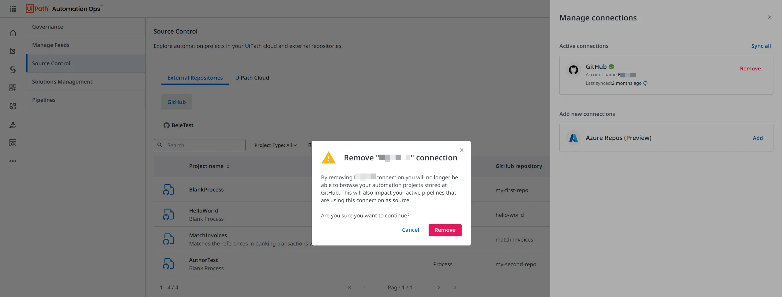

You can remove the exisiting connection from the Connection settings menu > Remove.
When removing the connection in UiPath, the app installed on the GitHub side is also removed.
'Removing the connection' image

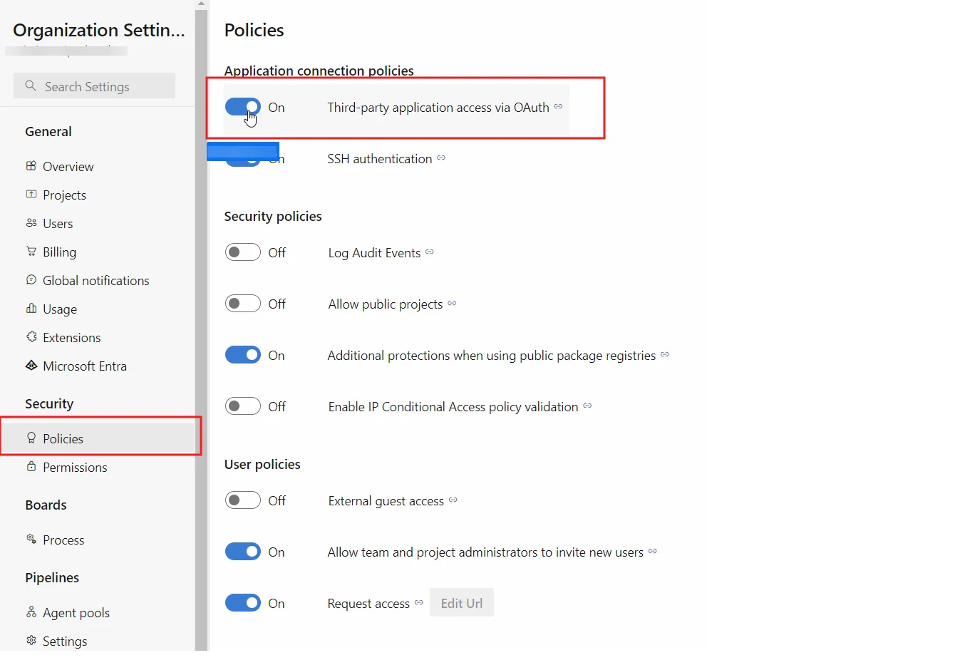

To sync your projects, you must enable the Third-party application access via OAuth at your Azure Organization settings level. For this, you have to access the Policy tab under Security. Enabling the option must be done before the authorization to your Azure Repos account. If you have already established the authorization, you need to resync the connection.
'Third-party application access via OAuth' image

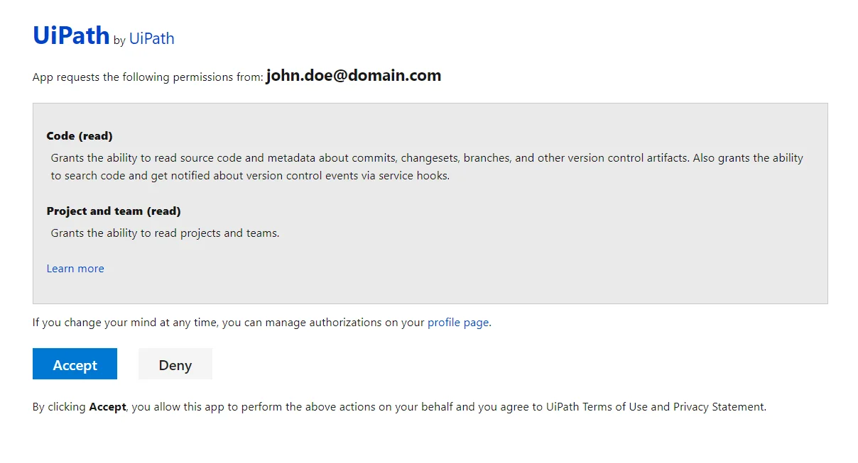

If the user that allowed the connection to Azure is part of multiple organizations and you want to avoid the content from a specific repository to be displayed in Automation Ops™, you must make sure that 3rd party integrations are disabled on the Azure side for that organization.
'App permissions request' image
Once you select Accept, you are redirected back to Automation Ops™ where the list of available projects is populated.

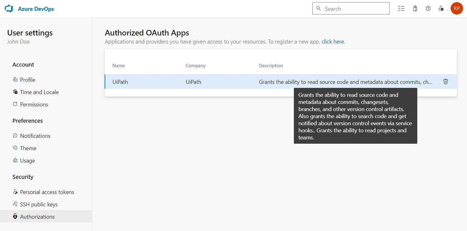

To remove the integration between UiPath Automation Ops™ and Azure Repos, you have to access the Authorization tab under User settings on the Azure side and delete the authorized app from there, afterwards, you can remove the integration from the Manage Connections tab in Automation Ops™ - Source Control.
'Authorized OAuth apps' image

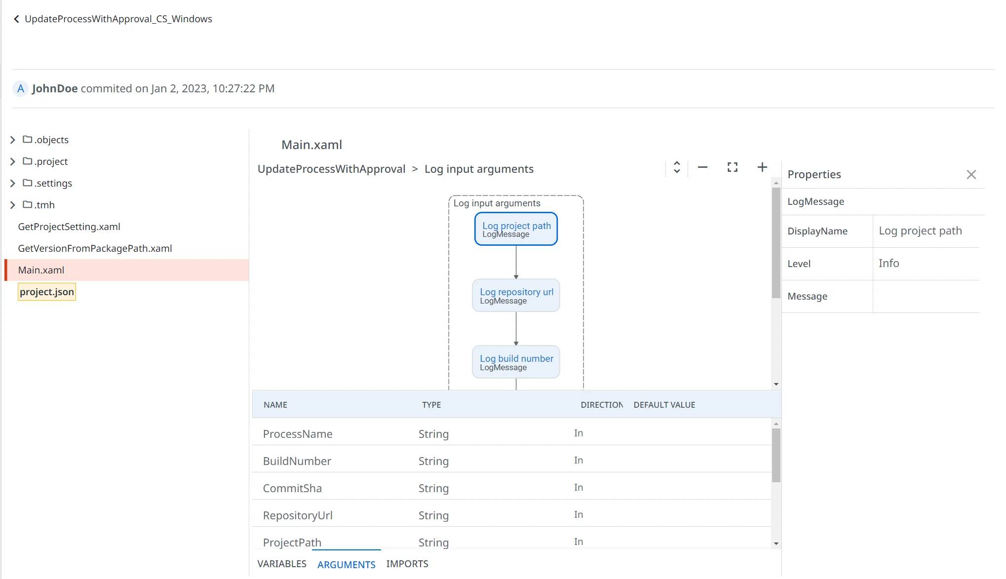

Viewing the details of a commit
Opening a commit allows you to view the files that are part of the project in more detail.
  • For workflow files, a Studio-like view is available.
  • For other file types, a content-view is displayed based on the file type.
  • Selecting Variables, Arguments, or Imports provides details on each of them.
    'Viewing the details of a commit' image
