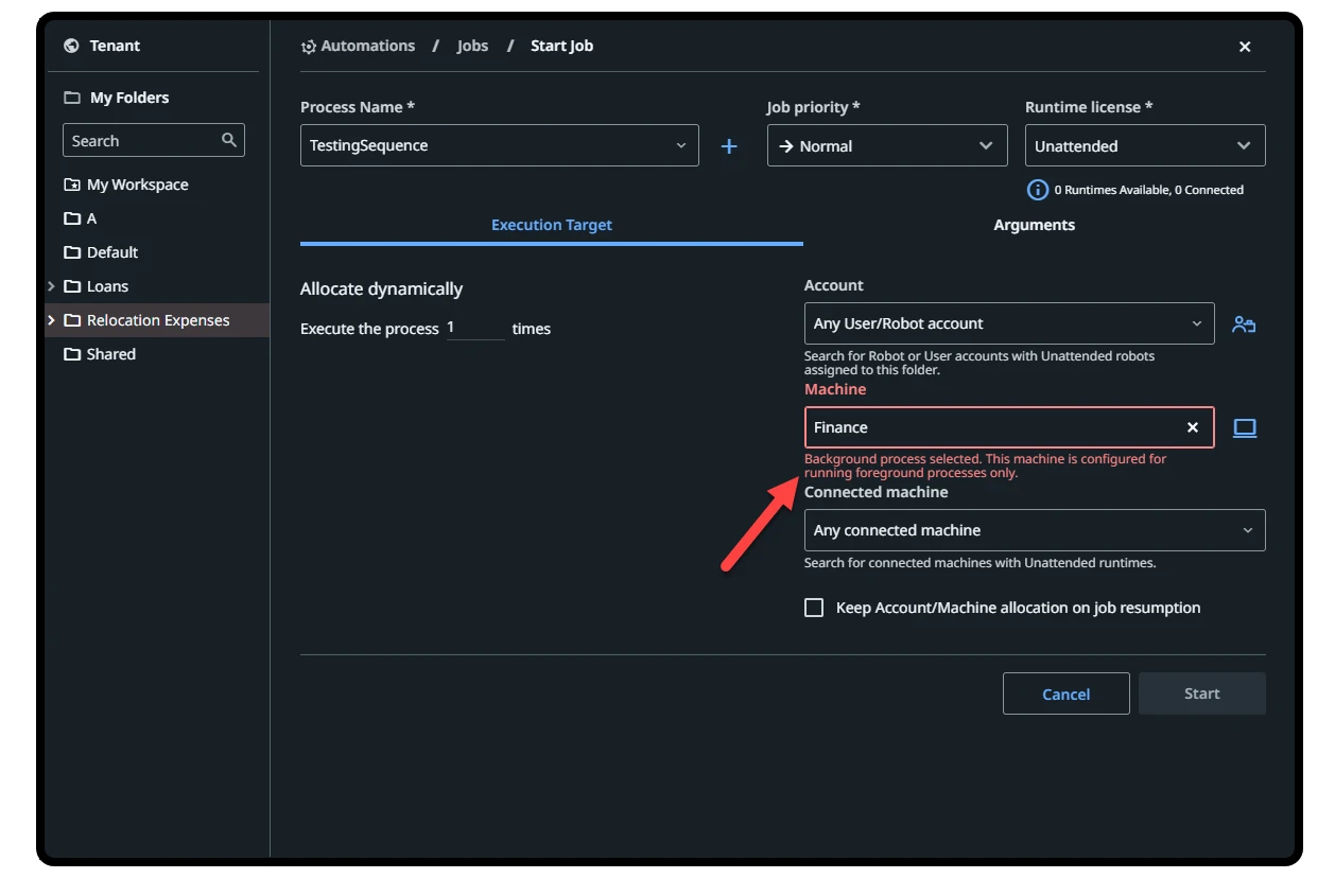

      Orchestrator prevents starting jobs on invalid configurations. Trying to start a job in an invalid setup results in a descriptive error message providing you with details about how to fix your configuration.
      docs image
      Starting a job using dynamic allocation, i.e. no machine or account specified, with an incompatible folder setup results in an error. Make sure to correct the setup, otherwise, jobs stay pending indefinitely. For example, trying to run a .NET Framework 4.6.1 background job when there are only cross-platform templates in the folder does not work, as jobs stay pending until the configuration is fixed.
