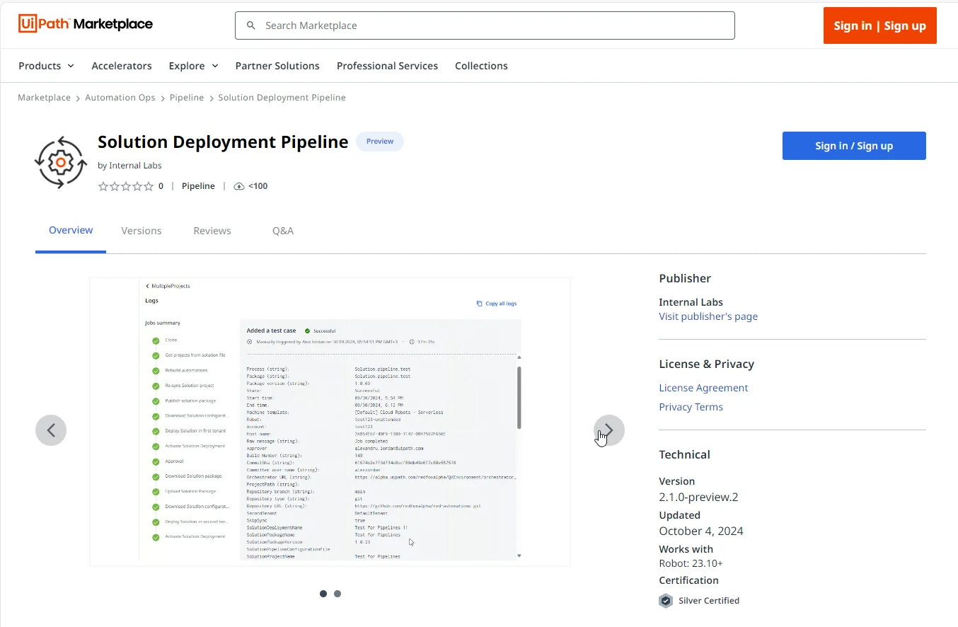

You can use use pre-built pipeline from Marketplace. You need to download the Marketplace package, create a process out of it, and assign the Solution specific roles, as detailed in the following steps:
Note:
The Solution project must be set up in advance before you can deploy it using Pipelines.
  1. Download the Solution Deployment Pipeline package from UiPath® Marketplace.

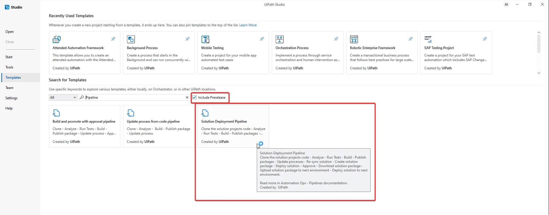

The Solution Deployment Pipeline process is pre-built to cover most of the use cases. However, you can customize it, to meet your needs. To do this, you need to retrieve the template from Studio and fine-tune it. For more details about templates in Studio, refer to About the Pipelines activity package.
'Creating a custom pipeline from the template' image
Note:
Make sure that in Studio > Templates, the Include Prerelease option is enabled.

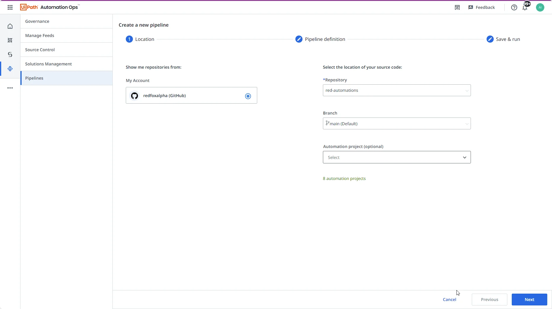

  5. Create a pipeline in Automation Ops. To trigger the pipeline whenever a change occurs in the entire repository (any of the solution's projects changes), select only the repository, not also the project at the first step of the pipeline definition.
    'Create a pipeline' image
  6. Set the pipeline arguments and start your pipeline.

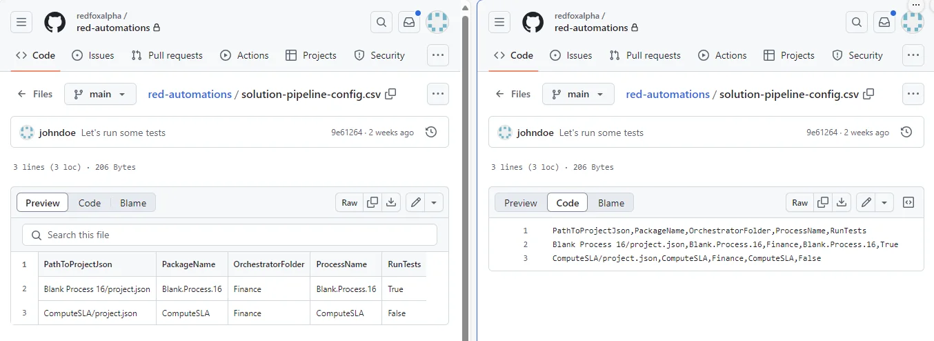

Solution pipeline configuration file
The Solution pipeline configuration file maps the automations used in the Solution to their source code projects. The pipeline needs such a mapping to know what projects to build, and where to place them in order to update the Solution. This format is just a proposal used by the pre-built pipeline. You can use your own format when you create you custom pipeline process.
The Solution pipeline configuration is a .csv file with the following format:
PathToProjectJson,PackageName,OrchestratorFolder,ProcessName,RunTests
Important:
The first line is the header of the .csv file and it is required.
Each of the lines configures the actions that are performed on a project, as described in the following table:
NameDescription
PathToProjectJsonThe relative path to project.json from the root of the repository.
PackageNameThe name of the package created from the project.
OrchestratorFolderThe location where the process will be updated in Orchestrator.
ProcessNameThe name of the process to be updated.
RunTestsWhether to run tests or not as part of the pipeline.
The following is an example of a configuration file:
Blank Process 16/project.json,Blank.Process.16,Finance,Blank.Process.16,True
ComputeSLA/project.json,ComputeSLA,Finance,ComputeSLA,False

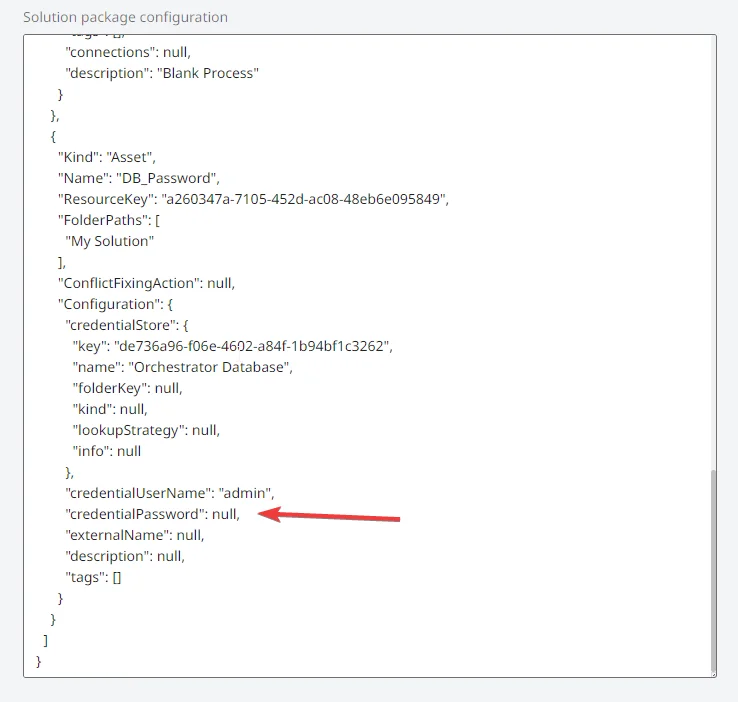

A typical use case for it is setting the passwords in Credential Assets used in the Solution.
Credential Asset passwords that are part of your Solution are not stored in the Solution package and you need to specify it during deployment.
'Solution builder' image
To set the password as part of the pipeline you need to download the Solution package configuration file and update accordingly. The password must be updated dynamically, on-the-fly.
'Solution package configuration file' image
