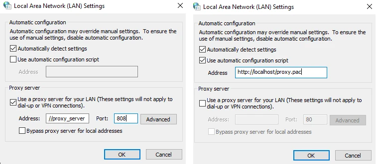

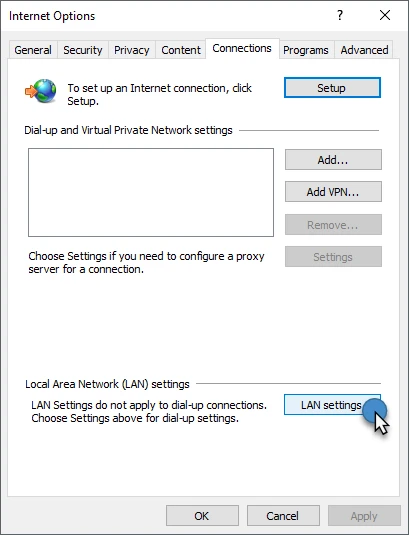

Configurations for the Proxy Script or Proxy Address can be set from either the Connections section in Internet Options or from the Proxy Settings menu in the Windows Settings.
Configuring the Web Browser
In Internet Explorer, click Tools > Internet Options. The Internet Options window is displayed.
In the Connections tab, click LAN Settings. The Local Area Network (LAN) Settings window is displayed. Depending on your setup, you can set a proxy configuration script or a proxy server.
Configure the Proxy Server or Automatic Configuration (for Proxy Script).
Click OK. Your settings are saved.
In the web browser, enter the Orchestrator URL to test the connection.

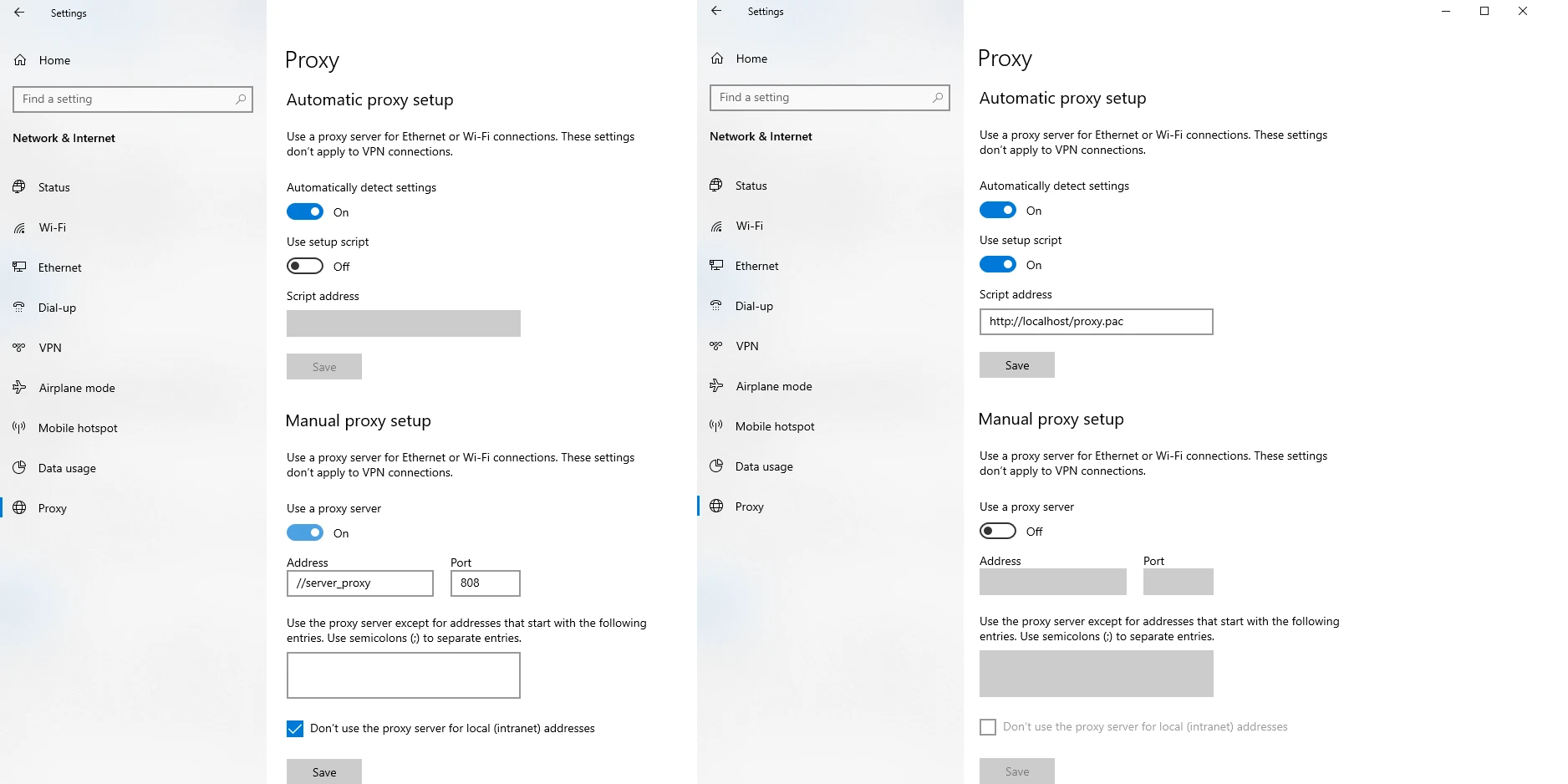

Configuring the Windows Proxy Settings
Open the start menu and search for Proxy Settings.
Configure the Automatic Proxy Setup (for Proxy Script) or Manual Proxy Setup (for Proxy Server).
Save the settings.
Important:When setting up or editing the proxy address, do not add the http:// prefix to the proxy address. This enables the proxy only for HTTP calls, and since most calls are HTTPS, the proxy configuration fails.
To resolve this, make sure to either remove the http:// prefix altogether, or specifically add the proxy address with both http:// and https:// prefixes.
