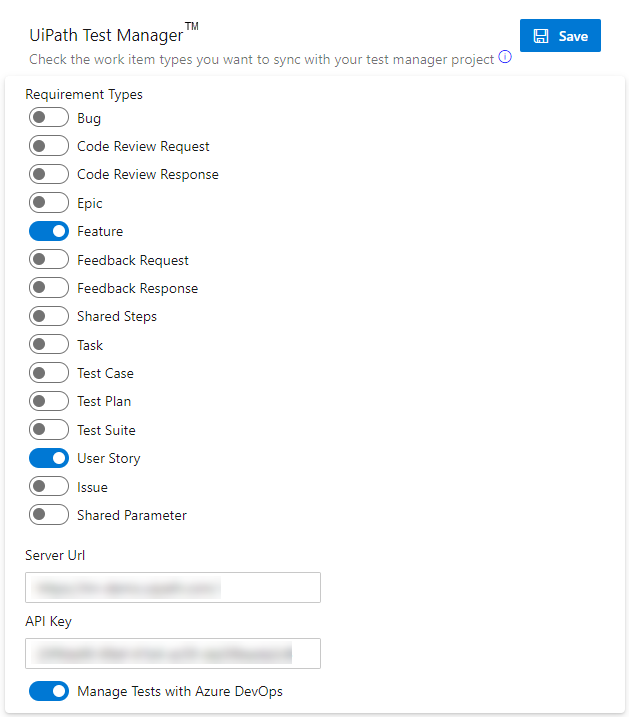

  9. Configure the following extension settings:
    • Requirement Types: Select the types of objects you want to assign a test to. These will show up as requirements in Test Manager. For more information, see Requirements.
    • Server URL: Add the Test Manager URL. The URL should have the following format: https://{yourDomain}/{organizationName}/{tenantName}/testmanager_.
    • API: Paste the API key.
    • Manage Tests with Azure DevOps: Select this option to manage your tests through Azure DevOps. Otherwise, leave this option off, to manage your tests through Test Manager.
  10. Click Save.
