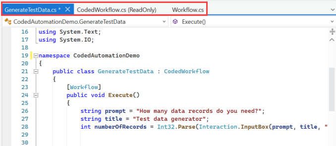

The code editor opens files inside your project with tabs, in the editor's header.
When you open a file, a new tab is displayed for it.

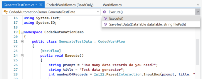

In the code editor header, you can navigate through classes and methods inside a file, using breadcrumbs.
