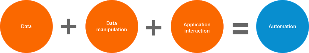

An RPA process can be simply defined as a combination of data, data manipulation, and application interaction.
docs image
  • Data - Pre-defined data types selected when defining variables or arguments, or your own types that you can import and use in Studio. In addition, the Data Service feature introduced in v2020.10 offers a centralized location where you can create data types and reuse them across automations.
  • Data manipulation - This can de done through activities which are the building blocks of automation and/or data manipulation expressions. Activities are available in packages that you can install in Studio. You can also create your own custom activities when certain functionalities are not covered by the available packages. For more information about how you can build custom UiPath activities, see Creating a Custom Activity.
  • Application interaction - This can be done through UI Automation or integrations/APIs. UI Automation can be used for most applications available today. UI interaction components can be reused with the help of libraries or the Object Repository.

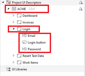

For example, in the image below we can identify:
  • UI Application: ACME version 1.0.0.
  • Screens: Dashboard, Invoices, Login.
  • UI Elements: Email, Login button.

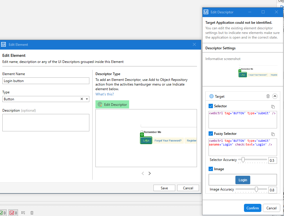

For each element and screen in the Object Repository, provide the following details:
  • The exact name of the screen, page, or element, as it appears in the UI (for example, Login button).
  • The type, for example Button or Input (only for elements).
  • An optional description. We recommend adding a quick overview of how the element can be used (for example, Click Login to complete the login process).
  • UI Descriptor - Information that uniquely identifies the element. Incorporates classic selectors, fuzzy selectors, and image-based automation. We recommend using image-based automation only if the other methods don't work.
    docs image

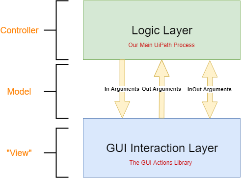

Using this methodology, the main automation project (the controller) will contain all the process-dependent logic and it will interact with the UI by leveraging the workflows inside the library (which can be thought of as a pseudo-view). Finally, the model is represented by the arguments which help us pass data between these 2 components.
docs image

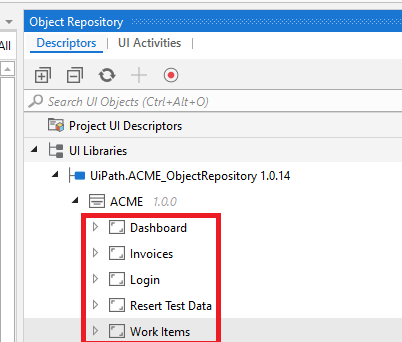

  1. Create the application object and the necessary screens in the Object Repository.
    docs image

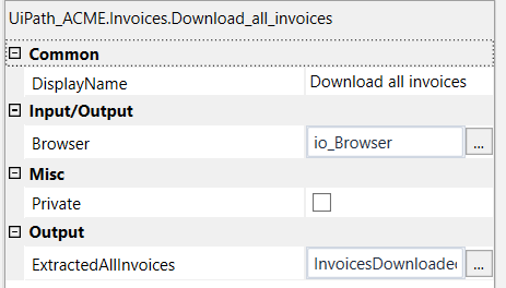

Arguments
  • Name arguments using the PascalCase standard. This is the standard used for the parameters of activities in UiPath Studio libraries.
  • Do not include in_, out_, io_ prefixes in the argument names because they will appear as properties of the activities in the library.

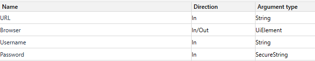

For example, arguments could look like in the image below. If you look at your published component, you can see that your arguments are already separated in different categories based on their type, so adding the prefix would be redundant.
docs image

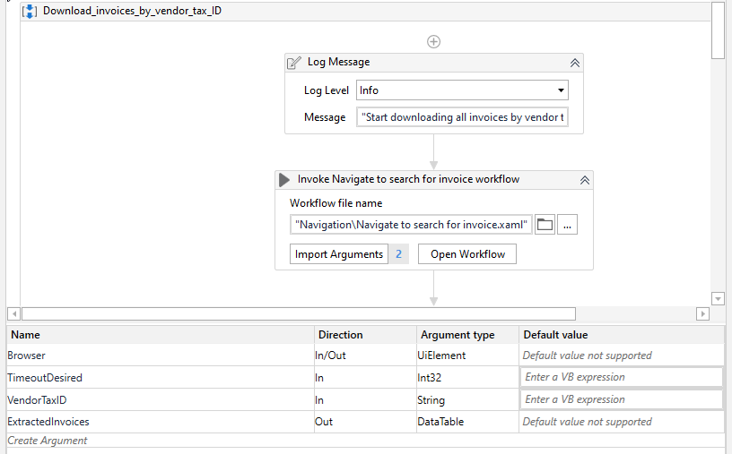

  • All workflows inside a GUI library which open / launch the application to automate (for example, an activity that opens and logs in to the application) should return the resulting application window using either an out argument of type UiPath.Core.UiElement for the modern design experience, or UiPath.Core.Window or UiPath.Core.Browser for the classic experience. Additionally, for both classic and modern experience, all other activities in the package should have an in argument of type UiPath.Core.Window or UiPath.Core.Browser which will indicate the correct window in which the current action should be performed. This is extremely helpful if you have multiple instances of an application open during the runtime of the processes. If you are using the classic design experience, do not send selectors as arguments.
Developing a library of automation components for the ACME website (you can download example library below) requires a component which opens the browser and performs the login operation. This activity should take as arguments the username, password, site URL, and return the Browser element. Optionally, to support a scenario in which the login takes place in an existing window, the browser can be sent as an in/out argument.
The Browser element is of type UiPath.Core.UiElement:
docs image
This is how the arguments would look like:
docs image

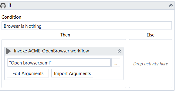

When building the workflow that opens the browser (for example, the Login workflow), you must first check if the Browser argument is null and, in case this is true, open <https://acme-test.uipath.com/> in a new browser in a separate workflow:
docs image
After the login is performed and the Browser element is passed back to the process, all other activities from this library will require this parameter. For example, the activity that downloads all invoices from the website will have the following parameters:
docs image
If a valid browser is not passed to this activity, the execution results in an error.

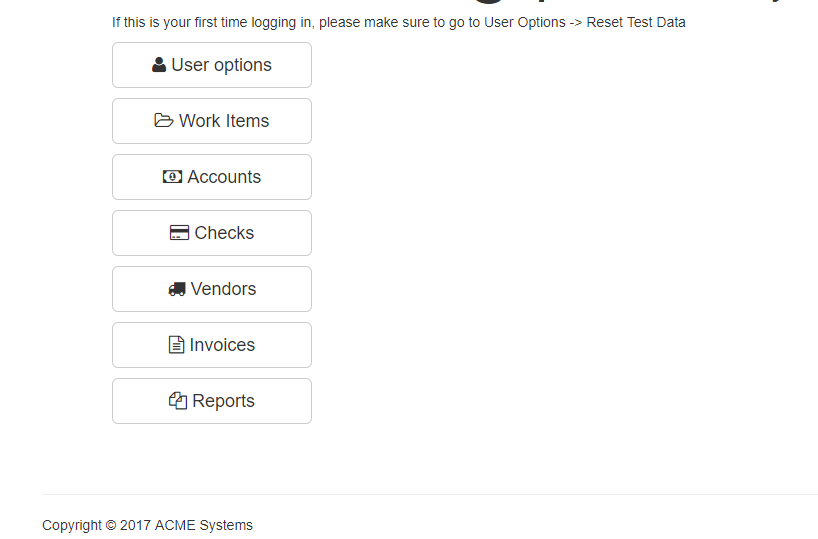

Example
The ACME website (https://acme-test.uipath.com/) contains several pages which allow users to interact with entities such as Work Items, Checks, Accounts, Vendors, Invoices, etc.
docs image

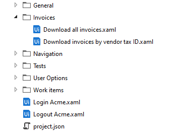

When creating a library with components that interact with the aforementioned items in the ACME website, you can create a folder structure and name the workflows in the library as in the following image:
docs image

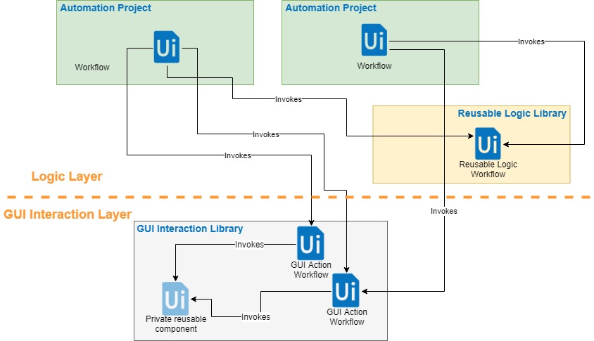

Approach for larger solutions
In larger automation projects, several components inside a library may have a very similar or even identical piece of code. In this case, you should isolate this component in a separate workflow and, if you don't want this workflow to be accessible outside the library, mark it as ignored from publish to make it private.
Additionally, it is possible that the same logic needs to be implemented between multiple processes. In this case, the reusable piece of logic should be isolated in a separate library.
The following diagram gives an overview of how a solution like this might look like:
docs image

Library
The library containing all of the ACME automation activities is called Acme_ObjectRepository. You can find the latest version below:
Even though the library is a module focused on the interaction with the ACME web application, it is also modularized and organized into multiple folders, based on their purpose:
docs image

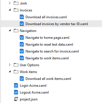

Here’s a quick breakdown of the library components:
  • Login Acme.xaml - Logs in to the application. It contains the following arguments:
    • Four In arguments (URL, Username, Password, TimeoutDesired).
    • The Browser In/Out argument of type UiPath.Core.UiElement This component will either attach to any ACME windows that are already open, or open a new browser window if one is not already open and perform the login. The browser parameter will return the browser window and this variable will be passed on to all other components in the library.
    docs image
  • Logout Acme.xaml - Invokes the Navigate to home page workflow from the Navigation module and subsequently terminates the current session.
  • User Options module - Contains the options that can change the current account's configurations inside the ACME web application.
    • Reset test data.xaml - Resets the test data used in the ACME application.
  • Invoices module - Contains the actions performed on the invoices found in the test data.
    • Download all invoices.xaml - Extracts all the items in the invoice table inside the application and returns them as a DataTable.
    • Download invoices by vendor tax ID.xaml - Navigates through the entire invoice table until it finds an invoice with a specific tax ID, which it then returns.
  • Navigation module - Contains workflows that navigate through the different pages of the web application
    • The components in this module are mostly used by the other library workflows, and usually should not be invoked directly from our main process. However, they are marked as Publishable because they might be useful in attended processes where we might want the robot to navigate to a specific page and then allow the user to interact with the application.
  • Work items module - Contains the actions which take place on the work items found in the application.
    • Download all work items.xaml - Downloads all work items in the test data.
